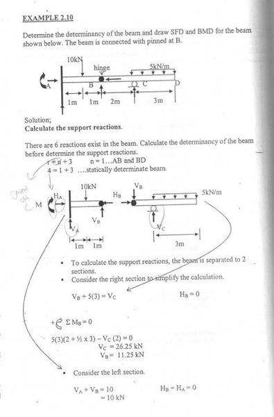

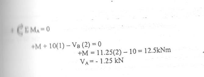

I'm having problem of finding the support reactions of Va , Vb and Vc
My working is VA +VB +VC = 10+5(3)
VA +VB +VC = 25
But , when i sub in the value of VA , VB and VC , it doesn't satisfy the equation of VA +VB +VC = 10+5(3) , why I'm wrong ? [/B]

Simon Bridge said:
Please explain your reasoning.
VA, vb and vc act upwards, while 10+5(3) act downward, upwards forces = downward forces
