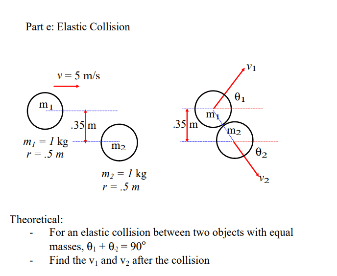

How Do You Solve a 2D Elastic Collision Problem with Angle Relationships?
5 replies · 2K views · last reply
chadarebubble
The attached file is all the information on the problem
.5mv^2 =.5mv1^2 + .5m2^2
p = mv
I've tried plugging the known values in the equations and and substituting the various equations together and every time I come up with an equation that has two unknowns in it.

Did you write down three (3) equations? Two for momentum conservation and one for energy conservation.

yes I did, the equations I was able to come up with are:
V1cos(θ1) + V2cos(θ2) = 5 (momentum in x direction)
V1sin(θ1) + V2sin(θ2) = 0 (momentum in y direction)
.5(V1)2 + .5(V2)2 = 12.5 (energy conservation)
θ1 + θ2 = 90
I worked on these equations for about an hour and came up with nothing, and feel like there is something I'm missing

You are missing that sinθ1 = cosθ2 and cosθ1 = sinθ2. You should be able to get either one of these angles from the geometry of the collision.
