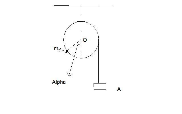

A uniform cylindrical pulley of mass M and radius R can freely rotate about the horizontal axis O. The free end of a thread tightly wound on the pulley carries a dead weight A. At a certain angle [tex]\alpha[/tex] it counter balances a point mass m fixed at the rim of the pulley. Find the angular frequency of small oscillations of the arrangement (refer figure).
Let the mass of the dead weight be m1
Considering rotational equilibrium about O, we have
m1gR = mgRsin[tex]\alpha[/tex]
i.e. m1 = msin[tex]\alpha[/tex]
Let the pulley be displaced through a small angle [tex]\theta[/tex] in the clockwise direction.
The Total Energy of the system after rotation through the small angle is-
E = mgRcos([tex]\alpha + \theta[/tex]) - m1gR([tex]\alpha+\theta[/tex]) + Iω²/2 + m1ω²R²/2
As the system is conservative, the time derivative of energy is 0
dE/dt = 0
on solving the above equation,
I got dω/dt = mgRsin[tex]\alpha[/tex] + m1gR/(I + m1R2)
Now m1 = msin[tex]\alpha[/tex] and I = MR²/2 + mR² ( I did not include m1R² as I already took its kinetic energy as m1ω²R²/2)
on solving further,
d[tex]\omega[/tex]/dt = 2mgsin[tex]\alpha[/tex]/[(1+sin[tex]\alpha[/tex])mR +MR/2]
which is not proportional to [tex]\theta[/tex]!
and hence not a S.H.M.
The answer given is ω² = 2mgcos[tex]\alpha[/tex]/[MR + 2mR(1+sinα)]
Please help!

a figure will help
Five comments:
  1. Check your signs. You have a sign error here.
  2. The mass A is undergoing pure translational motion. The cylinder is undergoing pure rotational motion. Combining these two to form one value, Iω²/2, is not a good idea.
  3. You have made a notational error here that will hurt you later. You are obviously using ω=dθ/dt here. That's fine, but later on you are using ω to denote the harmonic oscillator frequency. That frequency is not equal to dθ/dt.
  4. Purely stylistic comment: Don't mix latex math with HTML math. The results are strikingly ugly and hard to read. Stick with one or the other.
  5. Here's an HTML alpha: α
dE/dt = 0
This does not follow from your earlier result. Hint: What happened to θ?
Thanks Sir! I got my answer.
