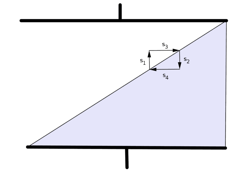

arnno
______|______
_____________
^ y
|_ _ > x
This is supposed to be a capacitor with a dielectric in a form of a wedge in it.
Known data: area A of the plates, permitivity [tex]\epsilon_r[/tex]
b is the depth of the capacity, l the length and d the space between the plates.
[tex]\frac{1}{dC}=\frac{1}{dC_1}+\frac{1}{dC_2}[/tex] [tex]=\frac{y}{\epsilon_0\epsilon_r dA}+\frac{d-y}{\epsilon_0 dA}[/tex] [tex]=\frac{1}{\epsilon_r\epsilon_0 dA} (y+\epsilon_r (d-y))[/tex] [tex]dC = \frac{dA \epsilon_r\epsilon_0}{(1-\epsilon_r)y+\epsilon_r d}[/tex][tex]=\frac{b\epsilon_r\epsilon_0 dx}{(1-\epsilon_r\frac{d}{l} x+\epsilon_r d)}[/tex]
[tex]C=\frac{A\epsilon_r\epsilon_0}{(1-\epsilon_r)d} \ln(\frac{1}{\epsilon_r})[/tex]
[tex]C=\frac{\epsilon_r\epsilon_0 A}{(\epsilon_r-1)d} \ln(\epsilon_r)[/tex]
So I sliced the capacitor in thin parallel capacitors (so the slices orthogonal to the plates of the original capacitor). Those are again two capacitors, one with permitivity epsilon_r, one without.
But if I now slice the capacitor in thin capacitors parallel to the plates of the big capacitor, I get a different solution, which can't be the case.
Where is my fault?
Thanks in advance,
arnno
PS: sorry for my untrained english
Your derivation is correct, but slicing the capacitor parallel to its plates does not work, as the planes parallel to the plates are not equipotential surfaces.
ehild
Thanks for your answer.
I wanted to comprehend that.
I've drawn a better picture of it and included a closed path.
If I now go on that closed curve the total potential has to be zero as it would otherwise violate conservation of energy. So I get:
[tex]\oint_C \vec{E}\mathrm{d}\vec{s}=0[/tex] [tex]\int_{s_1} E^\perp _0 \mathrm{d} y -\int_{s_2}E^\perp _r \mathrm{d}y + \int_{s_3}E^\parallel _0 \mathrm{d}x-\int_{s_4}E^\parallel _r \mathrm{d}x=0[/tex]
where E parallel is the electric field parallel to the plates and zero means outside the dielectric, the subscript r means inside the dielectric.
So with integral over the electric field equals the potential between beginning and end of the path I get:
[tex]U_{y,1}-U_{y,2}+U_{x,1}-U_{x,2}=0[/tex]
So if, as you have said, the planes parallel to the plates are not on equal potential there must be an electric field parallel to the plates so that conservation of energy holds. But how is that possible? Where does it come from? Is it because the electric field is refracted at the transition of the dielectic to the non-dielectric?
Thanks in advance again
arnno

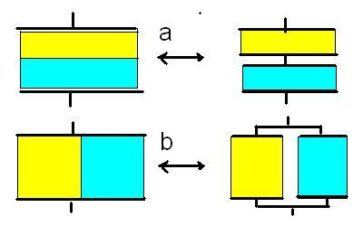

This is not all a simple problem. At the interface between two media, the parallel components of the electric field strength does not change but the normal components do : E2n/E1n=ε1/ε2, so the E lines "refract" at the interface. Even in case E was perpendicular to the plates in one medium, it would have an x component in the other one.

don't these standard techniques assume that the charge is uniformly spread over each plate?
it isn't in this case, is it? :redface:

The standard techniques apply in cases when the interface between the dielectrics is either parallel with the plates of the capacitor or normal to them (see picture).
In case a, the planar symmetry suggests that the equipotential surfaces are parallel to the plates, and both the electric field E and the electric displacement D are normal to the interface and uniform over the planes. As the normal component of the electric displacement D is the same at both sides of the interface, D is uniform over the whole capacitor. As the surface charge density is equal to D, the charge is uniformly spread over the plates. The interface is an equipotential surface, and can be substituted with a metal sheet, the capacitor is equivalent with two series connected ones.
In case b, the interface between the dielectrics is normal to the plates of the capacitor. The electric field can be considered normal to the plates because of symmetry. As the parallel components of the electric field are the same at both sides of an interface, E is the same at both dielectrics, E=U/d. The capacitor can be considered as two parallel connected ones, filled with different dielectrics.
The electric displacements are D11E and D21E, so the surface charge density is different at the parts of the capacitor filled with different dielectrics. If there is a stack of more dielectrics, the surface charge density is different over each one.
In both cases, the field lines all inside the dielectrics could be considered normal to the plates, which is not true for a wedge-shaped dielectric between the plates. So these standard methods do not apply, and I do not know, how the problem can be solved. What do you think, Tiny-Tim?
ehild
