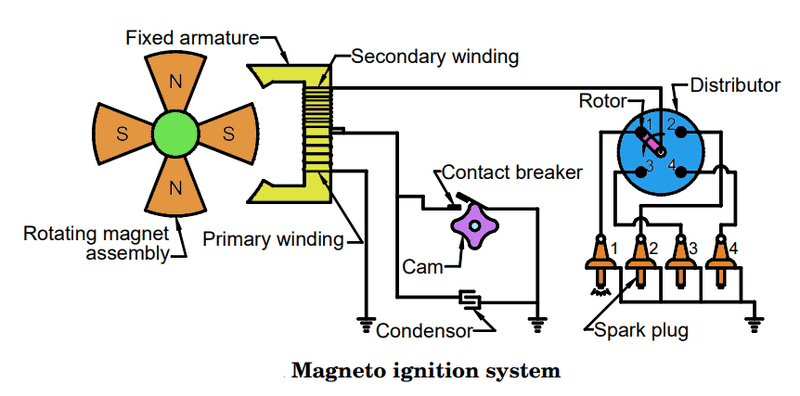

Beginning, this is what I think I understand?
To start the Physical Magnet (Pm) on the Mag shaft provides ac current to the primary winding; the PhysicalMagnet's change in the Number of MagneticLinesOfForce (MLof) going thru the PrimaryWinding (Pw) induces a current in the Pw. The current going thru the Pw INDUCES Mf around the Pw. That's ok when the Pm's SouthPole (Sp) is on the Left (L) and the Pm's NorthPole (Np) is on the Right(R).
And the Points are on the L.
Pm'sMLof always go from N to S, so it's reasonable the Pm INDUCED current would flow N to S; ie: R to L toward the Points.
PRIMARY WINDING
POINTS Left end of Pw S Right end of Pw N PwGround
1- The Pw is grounded on both ends; one end is grounded thru the Points to ground and the other end grounded to the Mag case. When the Points open why doesn't the Pm INDUCED current simply go to the other end of the Pw that is also a ground?
PRIMARY WINDING
POINTS Left end of Pw N Right end of Pw S PwGround
When the Sp is on the R and the Np is on the L; now the current is going in the opposite direction thru the Pw. And the Opposite direction Current is INDUCING a Mf in the opposite direction.
2- The Pw is grounded on both ends; one end is grounded thru the Points to ground and the other end grounded to the Mag case. The Pm INDUCED current is already going toward the R end of the Pw that is a ground, why is the current stopped by the Points opening?
Does this make any sense??? Hope the abbreviations make things simpler.

Is there a diagram that goes with your explanation? Use the "Attach files" link at the lower left of the Edit window to upload the diagram.
I'm not an expert in this area, so I've attached a diagram I found on google to reference. The diagram doesn't do a good job of showing it, but note that the secondary and primary are either grounded together on one end or both simply attach to the common ground at separate points. The other end of the secondary is grounded through the rotor and distributor, while the primary appears to be grounded through the condensor/contract breaker part of the circuit.
According to this diagram and several more, the primary winding has one end directly grounded and the other end grounded through the condenser/breaker circuit, as shown above. Assuming that 'points' means the contact points on the distributor, then they have nothing to do with the primary winding.

Looks to me like it is the secondary winding that connects to the points on the distributor.
Let me see if I can simplify my concern:
As the drawing clearly indicates, the Pw has 2 Grounds: 1st ground (Direct Ground) is connected directly to (as you say) a common ground; the other Pw ground is thru the Points (Contact Breaker) to a common ground. So the question is when the Points open, the first ground is lost, why doesn't the Pw current simply go to the Direct Ground? For some reason, that I don't understand, when the points open the Pw current stops.
If you have a lite bulb on with two grounds and for some reason you disconnect one ground, the bulb is still on.
When the contact breaker is opened, there isn't a complete circuit anymore. The current can't go through the capacitor (condensor) and it can't come from or go to the other ground, as there would quickly be a buildup of charge in the disconnected side that would stop it.
I'm not sure what you mean about the light bulb having two grounds. There needs to be a complete circuit for current to flow through. If there is still a complete circuit after disconnecting from one ground, then the light bulb will light up. If there isn't, then it will not.

That diagram is missing something, I think. The magneto on my old motorcycle had a physical linkage (same shaft) between the magnet and coils and the breaker 'points'. This times the breaking of the circuit with the appropriate part of the varying field around the coil. Breaking the circuit at the right time produces a far higher voltage than just having 'AC'. Automatic advance of the spark was achieved by flying weights that changed the angle of the plate holding the points. (No vacuum advance, though)
The magneto system was used by early aircraft (& cars) because they had no on-board appropriate electrical system. You would start by turning the prop - and could lose an arm if you weren't too careful.
EdgarW said:
With both ends of the Pw grounded it seems that the direction of the MLof would use the ground at the opposite end of the Pw;
What exactly do you mean by, "use the ground"? Current will flow in a loop, going into/out of either ground in order to make that loop. So when current flows into the ground at one end of the primary winding, it will flow out of the ground at the other end. Same for the secondary.

Is this just a matter of semantics? "Ground" is a term often used to describe the nearest large conducting object - for example, the car, plane or equipment chassis in which the Potential Difference between all connected points is (near enough) 0V. The assumption can easily fail when alternating voltages are involved.

No, I don't think so. The phrasing used by the OP suggests that he thinks that only one ground is being used at a time, and I want to make sure I'm understanding what he is saying.
We can't know but I look at the thread title with the word 'aviation'. That implies the OP could be thinking there's something special about the Earth, other than the term 'earth' meaning a common reference point - with an abritrary zero origin. Planes can't be connected to The Earth but the magneto works the same wherever it is.
