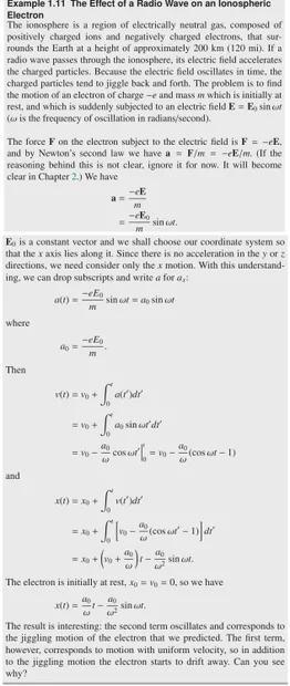

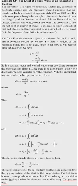

Taking a oscillating electric field ##E=E_0\sin\omega t##, we use kinematics to find the position of an electron under its influence : ##x(t) = \dfrac{a_0}{\omega}t-\dfrac{a_0}{\omega^2}\sin\omega t##. The second term is obvious - the electron oscillates too. But how do we explain the first term, which shows that the electron also "drifts" with uniform velocity along the same direction as that of the electric field. ##\text{How to understand this drift?}##
Statement of the problem : The problem is a solved example in Kleppner and Kollenkow's book, p. 21. The example is titled : "The Effect of a Radio Wave on an Ionospheric Electron". I copy and paste the example below and underline the last bit in red, which is my area of doubt. I hope the text is readable.
Question : The authors use the an oscillating field in one direction ##E=E_0\sin\omega t## to derive the position of the electron which is located at the origin at rest when time starts. The position of the elextron as a function of time turns out to be : ##x(t) = \underline{\dfrac{a_0}{\omega}t}-\dfrac{a_0}{\omega^2}\sin\omega t##.
The underlined term in the equation is the puzzle, which the authors refer to towards the end. They say that it "corresponds to motion with uniform velocity, so in addition to the jiggling motion the electron starts to drift away. Can you see why?" (my emphasis)
I am afraid I don't see why. Far as I can tell, the electron should oscillate back and forth about the origin ##x=0##.
Guess : (and of course I could be wrong), is that this is connected to the time-dependence of the electric field. As the electron oscillates, the field changes during that time. This keeps changing the mean position of oscillation for the electron, further ahead with time. But why is such a drift unform, even assuming I am correct? No clue as of yet.
Many thanks.

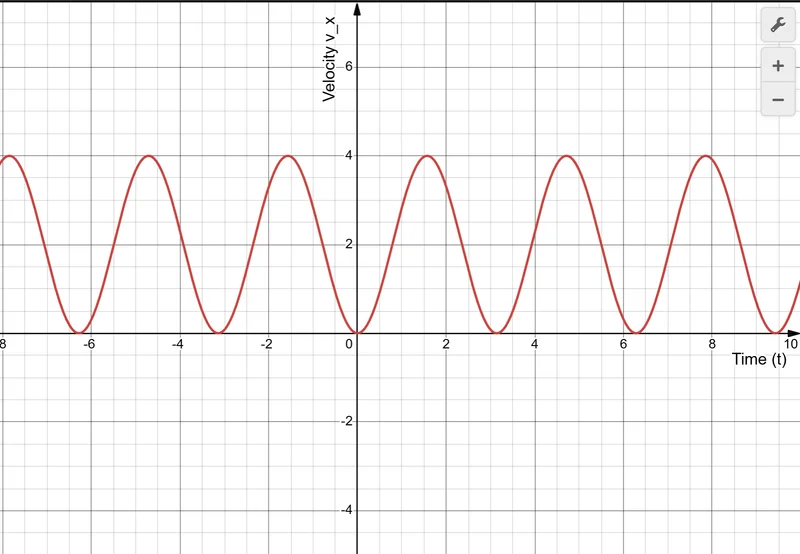

Look at ##\dot x## instead of ##x##. What is the range of ##\dot x##?
##v(t) = \dfrac{a_0}{\omega} (1 -\cos\omega t)##
Assume you repeat periodically:
accelerate your car from 0 mph to 65 mph, then press the brake pedal to decelerate from 65 mph to 0 mph.
Then your car drifts in average.

Yes, let me calculate. We have the position of the electron relative to the origin O : ##x(t) = \dfrac{a_0}{\omega}t-\dfrac{a_0}{\omega^2}\sin\omega t##. Upon differentiating, ##\dot x(t) = \dfrac{a_0}{\omega} - \dfrac{a_0}{\omega}\cos\omega t##. To check, this matches the initial condition of "at rest initially" : ##\dot x(0)=\dfrac{a_0}{\omega}-\dfrac{a_0}{\omega}=0##.
We find that the velocity of the electron ##v_x (=\dot x)## has a drift component, independent of time. It would be good to plot the velocity function with time. I have taken ##a_0=1\;,\;\omega = 2##. The cosine curve is pushed up by the amount ##a_0/\omega##.
At time ##t=2n\pi/\omega##, the cosine term vanishes but the first term remains : ##x(2n\pi/\omega)=\dfrac{a_0}{\omega}##.
Is this the term responsible for the drift speed of the electron?

A.T. said:
Consider for simplicity what happens to a body initially at rest that experiences acceleration ##a## for 1s, and then ##-a## for 1s. Does it end up in the same place it started?
Imagine the body to start from the origin. After 1 s, the body is at a position of ##x(1)=\dfrac{1}{2}a## with a velocity ##v(1) = a##. After another second of deceleration by the same amount, the position of the particle is ##x(2) = a-\dfrac{a}{2}= \dfrac{a}{2}##. As for i ts velocity : ##v(2) = a-a=0##.
We find that while the particle returns to rest, it is not at the position where it began, but "ahead" of it. Clearly, this is the result of the velocity given to the body during the initial acceleration.
Yes, exactly. Acceleration is the derivative of velocity, so with equal but opposite acceleration phases, only the velocity changes cancel, but not necessarily the position changes. This also applies to the Coriolis accelerations on the way up and down.
Yes.
Note that each cycle accelerates and then decelerates the electron. The acceleration portion accelerates from zero to some positive velocity. The deceleration portion is symmetric. So it decelerates from the positive velocity back to zero. So the velocity never becomes negative. Without the velocity becoming negative the particle cannot return to its original location.
