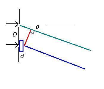

A thin film of dielectric material of refractive index 1.455 and thickness 6.50 mm is now placed over one of the slits (say the right-hand one). By how much will this change the optical path between the slit and the centre of the screen?

I've now been asked to calculate the new order of interference at the centre of the screen where the zero order originally occurred.
m = (OPD / λ)
m = 2.9575 / 6.33*10^-7
= 4672.2
This doesn't look right to me.
I was thinking that either my OPD is incorrect, or the m value at the original m=0 does equal 4672.2, and this number just represents the number of full cycles (wavelengths).
Therefore, 4672.2 * 633nm = 2.95mm (displacement from original m=0 to new m=0)
I hope this makes sense...

The big number is confusing me because I thought that maybe I should be using a different equation because the dielectric isn't a 'thin' film. However, I then started to wonder what actually defines a 'thin' film? Isn't it relative to the distance between the slits and the screen. In this questions case, the dielectric is 6.5mm and the distance between the screen and the slits is around 5.13m, therefore would I assume it's a thin film, relative to the distance between the slits and the screen.
I've added a more detailed calculation I did last night.
m = | t/λdielectric - t/λair |
|absolute value| used to get a positive m value.
ndielectricdielectric = nairair
t = m * λair*nair/(ndielectric-nair)
0.0065 * 0.455 = m * 6.33*10^-7
(0.0065 * 0.455) / 6.33*10^-7 = m
m = 4,672 = new order of interference where the m = 0 order of interference originally was before the dielectric material was placed over one slit.
m * λ = OPD
4672 * 6.33*10^-7 = 2.95 mm
Would the last part of this equation m * λ = OPD = 2.95 mm be the distance where the new m = 0 (order of interference) occurs with the dielectric over the right slit.
I'm assuming the new m = 0 (order of interference) is to the right of the original m = 0 (order of interference) position, because when the light leaves the dielectric it curves away from the normal.
The new m=0 order occurs when the path difference between the rays emerging from both slits have the same pathlengths.
The beams decline from the normal. You can determine the angle θ when the optical path difference is zero (between the green and blue rays), but it is a bit complicated.
By the way, thin film means that the thickness is comparable to the wavelength. It can be in the micrometer range or less.
