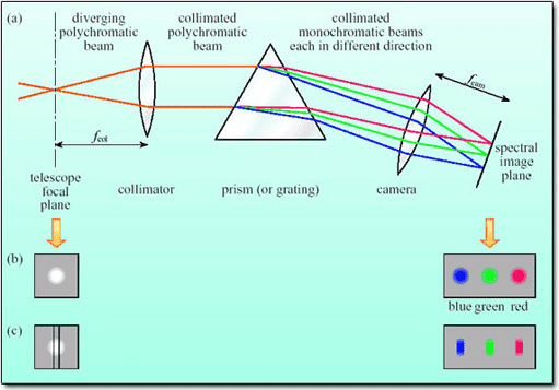

Something like this should be what you want. Can you show a diagram of your set-up? Are the lenses at the proper distance to collimate and focus the beam?
I sounds like you might be imaging light from the slit that didn't go through the prism. You need an opaque screen surrounding the prism so the only light that gets to your detector is light that went through the prism.
Thanks for your help on this. My set up is nearly identical to the diagram you've drawn, just a larger incident angle on the prism. The light is collimated to about a meter in length with <1mm divergence in radius in the horizontal plane.

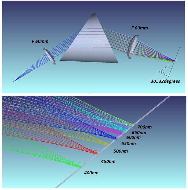

Your setup should work with a plano-convex or a double convex lenses. The plano-convex would be better option.
But because a single lens has to much aberration so the aberration blur is exceeding you dispersion separation. To be able to see a color separation you need to stop down your beam diameter to reduce aberrations blur. The image plane is strongly tilted, so to get the best sharpness I do recommend to tilt the image plane by about 32 degrees.
Cool software.
I see, so you think the effect is due to aberrations. Makes more sense then violating laws of physics. I could put an aperture before the collimating lens. Sad to see some light intensity go, it isn't very bright to begin with, but, I now see the issue in the physical sense.
Does this imply that the biconvex lenses have more aberrations which is why I can see the pattern, or is it the opposite? My understanding has been that planoconvex lenses have less aberrations than their biconvex counterparts. The difference could be that the biconvex lens is more shallow in shape.
