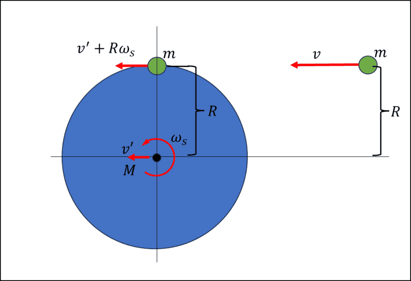

Also, my friend solves the problem in the following way:
##\vdots##
while for conservation of angular momentum it results[tex]mvR=mv'R+m\omega R^2+(2/5)MR^2\omega[/tex] The rotational momentum of the asteroid is zero.
Would you say that this is the diagram that goes along with your friends approach?
erobz said:
lets see if we can make sense of it.
I think so. Is that correct?
P. S. Could I ask you how you made the FBD? It's very nice!
Thats what I gather from the equation that is proposed by them for conservation of angular momentum:
$$mvR = m( v' + R \omega_s ) R + \frac{2}{5}MR^2\omega_s $$
How do you solve that for ##\omega_s##? please leave nothing to the imagination.
Thank You. its just PowerPoint.
It's not a free body diagram because it shows no forces. It's just a regular diagram showing a "before" and "after" picture in one.
I did not understand the request. Could you rephrase?
You are right, sorry. I have a bad habit of calling any kind of diagram FBD...
I'm asking you to solve that for ##\omega_s## in terms of ##v##, like was done in the other approaches.
My result is: ##\omega_s = \frac{5mv}{R (2M+7m)}##, if we consider ##Mv = Mv' + m(v'+ \omega_s R)## as conservation of linear momentum.
Ok, that is also what I conclude. So what is the final expression for the force?
My friend says ##F = m \omega_s R##, but it's wrong. The correct expression is ##F = m \omega_s d##, where ##d = \frac{M}{M+m}R##, as we have seen.
So, using the equations your friend derives we find that "##\omega_s##" the angular velocity of the sphere about its own center of mass was equal to "## \omega ##" which is the angular velocity of both masses about their common center of mass calculated by other methods previously discussed. Which leads to a clear discrepancy in the calculated force that ##m## feels. A force that your professor ( I presume ) has stated was correctly calculated with ##F = m \omega^2 d##? Does that sum it up?
erobz said:
So, using the equations your friend derives we find that ##\omega_s## the angular velocity of the sphere about its own center of mass was equal to ## \omega ## which the angular velocity of both masses about their common center of mass, Which leads to a clear discrepancy in the calculated forces. A force that your professor ( I presume ) has stated was correctly calculated with ##F = m \omega d^2##
##m\omega d^2## does not have dimensions of force. ##m\omega^2 d## does.
Yes. However, I would like to understand why my friend considered ##R## instead of ##d##. How should he introduce it into the analysis, since he has not mentioned it yet? Thanks.
The interpretation that your friend makes is not correct. @kuruman showed earlier how to conserve angular momentum about the mass center of ##M## using ##R##, but I believe it was also stated by @kuruman that angular momentum is only conserved about the systems center of mass. As far as I can tell your friend gets to the same angular velocity (symbolically), but it is doomed because it is about the wrong center of mass.
That seems reasonable. However, I would like to ask for confirmation from others as well. Just to make sure.
erobz said:
@kuruman showed earlier how to conserve angular momentum about the mass center of ##M## using ##R##.
Where? I cannot find it.
