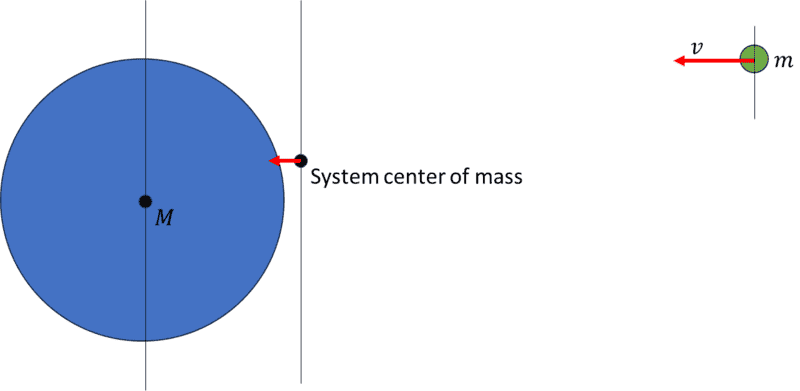

Now
##L_{\text{about cm}}=I_{cm}~\omega## which is the same as before.
##L_{\text{of cm}}=(M+m)V_{cm}(R-d)## because the cm is at distance ##(R-d)## from point O.
Angular momentum conservation about point O demands that $$\begin{align}
& L_{\text{before}} = L_{\text{after}} \nonumber \\
&mvR=I_{cm}~\omega+(M+m)V_{cm}(R-d) \nonumber \\
& mvR=I_{cm}~\omega+\cancel{(M+m)}\frac{mv}{\cancel{M+m}}(R-d) \nonumber \\
& \cancel{mvR}=I_{cm}~\omega+mv(\cancel{R}-d) \nonumber \\
& 0=I_{cm}~\omega -mvd \nonumber \\
& mvd=I_{cm}~\omega. \nonumber
\end{align} $$ Surprise, surprise!
I don't know if you noticed, but it is roughly the same procedure as mine in post #149. The equation I arrived at is the same.
  • #180
erobz said:
Its possible... the same way @kuruman and I had different approaches to the moment of inertia that appeared to be different on inspection, but were in fact the same.
This equation (1) seems like its keeping track of all the individual mass center momentums
This equation (2) seems like forget about that and just focus on the change in center of mass momentum.
Both of them make sense to me, and for some reason I decided to mix them...which I think was wrong.
The second is easy to solve. The first one is obviously more work, but I ( we) should probably try it to see if they yield to each other.
Equation (2) gives:
$$v' = \left(\frac{m}{m+M} \right)^2 v$$.
This equation has a power of 2 to the exponent over the expression of ##v_{cm}## that I had calculated and that @kuruman also calculated.
Equation (1) gives:
$$v' = \left(\frac{m}{m+M}\right) v + \frac{10 m^2 M}{(M+m)^2 (2M + 7m)}v$$.
This expression, in my opinion, has an awkward term on the right hand side. Most interestingly, if you change a minus sign to a plus sign in only one of the two round brackets referring to ##m## and ##M##, you get the expression:
$$v' = \left(\frac{m}{m+M} \right) v$$, that is, the same as before.
How can this be explained?
