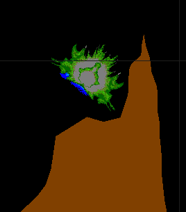

I think I understand where the difference is coming from. The engine is moving a greater distance than the center of mass in the rotating case, meaning more work can be done.
I'll calculate them separately, given this information.
so far so good:
