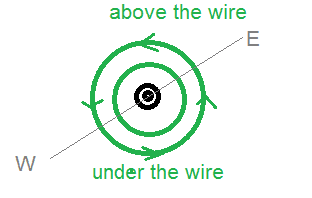

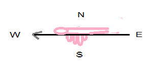

The magnetic field lines are circles around the wire, with the wire as axis. Take a pencil as wire and do the right thumb rule in reality. In what direction do your fingers point under the wire?
This is a very bad drawing, I was not able to make a better one. The wire and the cardinal directions are in the horizontal plane.

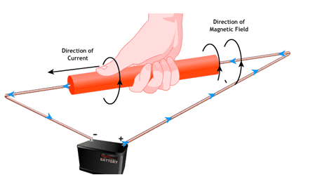

the plane of paper since north south east west are in plane of paper.
this is the answer but my fingers are coming out of the plane of paper
like this

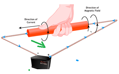

and this the actual question
I could get the numerical answer but not the the direction

Your fingers come out of the paper beside the wire or above it. Just under the wire the fingers stand in the North-West direction, and having short fingers, the tips would point to the South. The green vector represents the direction of the magnetic field under the wire.
This is a side view:
