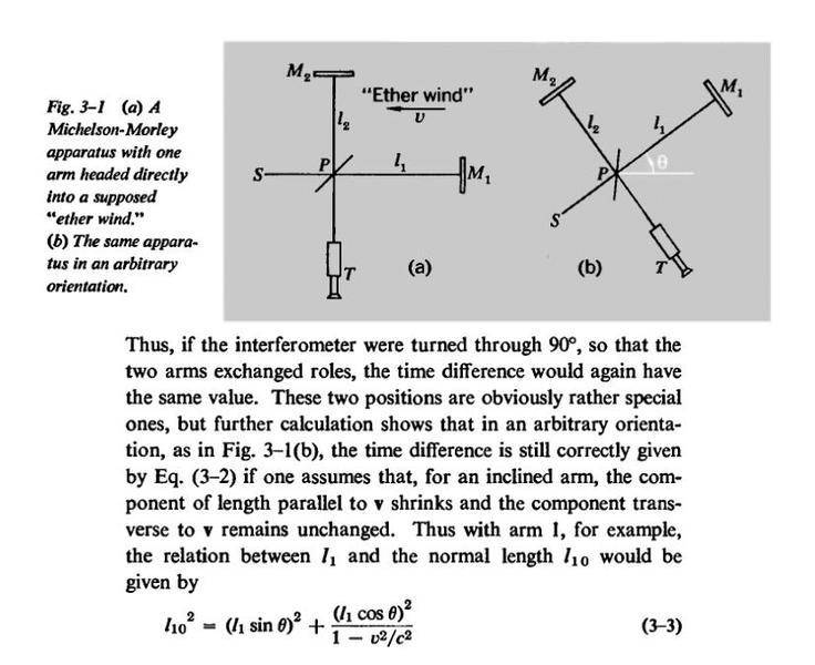

Length Contraction "Ether wind"
Due to the ether wind, anything that moves along it is "contracted".
Taking L1 to be contracted length,
(L1)2
= (L1x)2 + (L1Y)2
= (L10,X/γ)2 + (L10,Y)2But what they wrote is the opposite..
  • Two diagrams of a Michelson-Morley apparatus: (a) arms l1 and l2 aligned with an "ether wind" of speed v, and (b) the same apparatus rotated by angle θ, with labelled mirrors M1, M2, beam splitter P, source S and telescope T; below, an equation l10² = (l1 sin θ)² + (l1 cos θ)²/(1 − v²/c²) (3-3).
The equation (3-3) in the book is an expression for the "normal" (not contracted) length in terms of the components of the contracted length. Your expression is for the contracted length in terms of the components of the normal length.

Michelson Morley Experiment: Rotating setup
Apparently rotating the setup at an angle doesn't change the time difference between t1 and t2..
Two schematic diagrams of a Michelson-Morley interferometer, (a) and (b), with mirrors M1 and M2, beam splitter P, source S, telescope T, arm lengths l1 and l2, and an ether wind arrow labelled v; below, handwritten derivation of travel times t1 and t2 for a rotated setup at angle theta, and printed equations 3-3 and 3-2.
But the square roots below are clearly different..

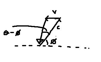

Can't seem to get it to be independent of ∅... it turns out as (θ-∅)

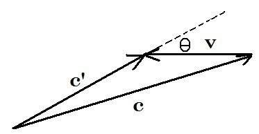

But all I'm saying is that if you let c' represent the speed of light along the arm ##l_1##, then you can express c' in terms of c and θ using relative velocity arguments. See the attached diagram.

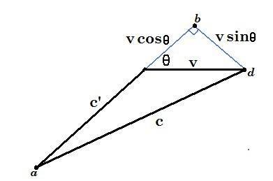

Perhaps a shorter way to derive c' in terms of c, v, and θ is to apply the pythagorean theorem directly to the right triangle abd in the attached figure.

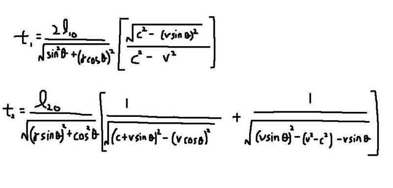

I worked it out and got some crazy-*** square roots...
Handwritten derivation of two travel times: t1 = 2l10 over the square root of sin^2 theta + (r cos theta)^2, times a bracket of sqrt(c^2 - (v sin theta)^2) over (c^2 - v^2); and t2 = l20 over the square root of (r sin theta)^2 + cos^2 theta, times a bracket of 1 over a square root plus 1 over a square root.
Good. Looks like your expression for t1 is correct. It will simplify.
For t2, I believe your expression in the square bracket needs some corrections.

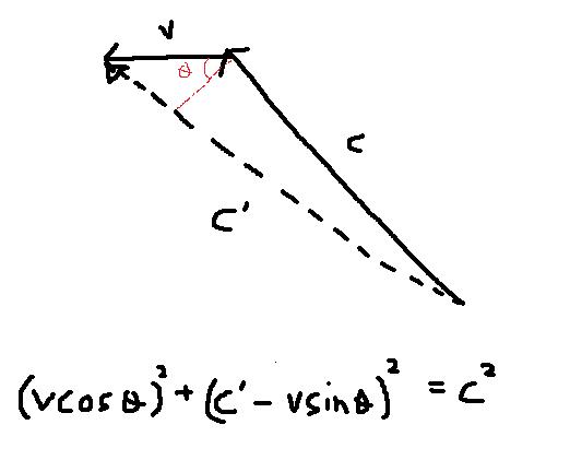

First pic shows the trip towards the mirror:
Handwritten vector diagram of a light path: a horizontal arrow v points left, a solid line c runs down-right from its tail, and a dashed line c' joins the ends with angle theta marked in red; below is (v cos theta)^2 + (c' - v sin theta)^2 = c^2.
Next pic shows the return trip:
Handwritten vector diagram of a light path against a wind velocity v, with sides c and c'' and an angle theta, followed by algebra expanding c squared and solving the quadratic for c'' as a square root minus v sin theta.
Everything looks good here. Just solve properly for c' and then simplify the expressions for t1 and t2.

I already did! And it got me:
Handwritten equations for two travel times t1 and t2. t1 = 2l10 over sqrt(sin^2 θ + (r cos θ)^2), times [sqrt(c^2 - (v sin θ)^2) over (c^2 - v^2)]. t2 = l20 over sqrt((r sin θ)^2 + cos^2 θ), times [1 over sqrt((c + v sin θ)^2 - (v cos θ)^2) + 1 over sqrt((v sin θ)^2 - (v^2 - c^2) - v sin θ)].
I'm thinking if i expanded t2 it will make things more complicated..
Your expressions for c' and c" are not correct inside the brackets for t2, even though your expressions in your previous post are correct.
