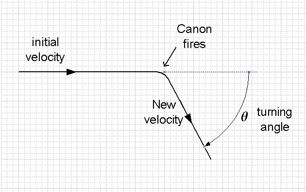

An astronaut in space weights 100 kg and is holding a cannon which can shoot a 10kg cannonball. The astronaut is moving at 10 m/s. The astronaut wishes to fire the cannonball such that he turns the maximum possible angle. Find this angle in degrees.
If we consider astronaut and cannon ball to be a system then on that system no external force and torque acts on it so we can use equations for conservation of momentum and angular momentum and energy.:rolleyes:
I have a confusion, when astronaut fires the cannon an impulsive force(due to recoiling) acts on it, due to which the astronaut rotates. Also as no other torque acts on it afterwards so I think it will go on rotating forever.:confused:
However I proceeded. I think for turning through maximum angle I think the initial kinetic energy of should get converted to the rotational kinetic energy. For finding rotational energy I need to calculate moment of inertia of astronaut first. But how?:confused: Also we can not consider as a point mass. Can we?
I believe what the problem intends to ask is the angle for which the direction of travel after the firing deviates the most from the direction of travel before (naturally in the frame where the astronaut is traveling at 10 m/s). Assuming the astronaut fires the cannon in such a way that the force is directed through the centre of mass, the astronaut will not actually gain any angular momentum.

I think the "rotation" here is meant to be the angle through which the trajectory changes, not a rotation of the spacecraft itself.
<<EDIT: Ah! Orodruin beat me to it!>>
Only because I did not take the time to draw a picture ... :rolleyes:

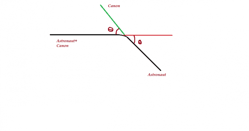

In order to use conservation of momentum I should know the direction and magnitude of the speed of the canon. Should I assume that canon is fired at angle ##\theta## (please refer to figure) with the horizontal.
The recoil angles of the two objects will not necessarily be equal. You can say though that by conservation of momentum the net momentum in the X and Y directions are separately conserved.
I was too thinking that. But if we assume that the velocity vector of canon makes angle ##\phi## with the horizontal and velocity of astronaut makes ##\theta## with the horizontal then by using conservation of momentum in X and Y direction and by conservation of energy I can make three equations but there are 4 variables.
Conservation of energy is a dubious thing to use here since the firing of the canon is analogous to an inelastic collision happening in reverse. Kinetic energy is not conserved across an inelastic collision.
If the canon ball's speed is not specified then perhaps a better approach is to simply assume that the firing of the canon imparts a change of momentum ΔP of some magnitude and direction. The canon ball carries off momentum ΔP and the astronaut suffers a change of -ΔP (since momentum is conserved).
Without knowing what the magnitude of ΔP can be you can't really say anything more specific.
