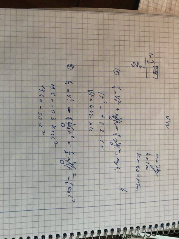

The weight is falling from a height of 1 meter. Then it touches a spring and it contracts. The weight of a body is 2 kg and k of the spring is 100 N/m.
1) What's the maximum contraction of the spring
The answer is supposed to be 0.852m(I got 0.392m)
E=1/2kx2
Diagram of a 2 kg mass resting on a vertical spring, with the spring's natural length marked 1 m, on a hatched floor. Hebrew text lists multiple-choice answers about the spring's constant of 100 N/m.
Handwritten physics working on grid paper, rotated sideways: a block of mass m = 2 kg on a spring of k = 100 N/m, with energy conservation equations and numerical substitutions below.
Your writing is not clear enough to be posting as images. Forum rules request you only use images for book extracts and diagrams.
Did you take into account that gravity does not stop acting when the mass hits the spring?
You do not need to find the impact speed. Just work with energy, end to end.

Thank you, I didn't put gravity to my equation. After I did, I got the right result.
