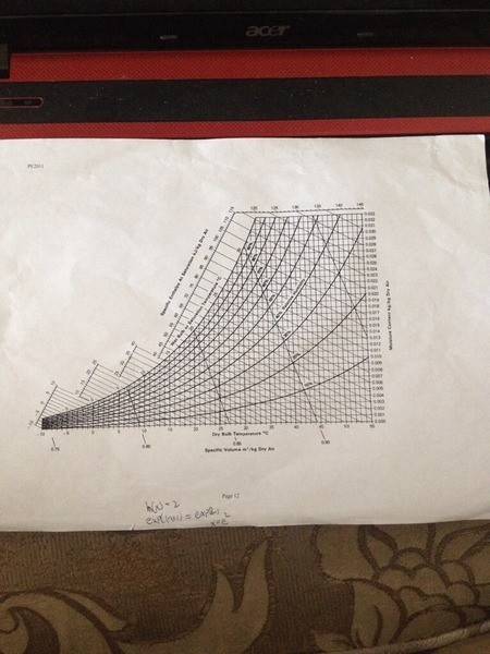

Thanks a million for that. Makes a lot more sense now. However, after looking at my psychometric chart I can't actually see any reference condition. I'll post a picture of it to clarify that. You see, it's not actually set of tables that we've been given. Only one handout of a psychometric chart in SI units.
The enthalpy is measured to be 0 kJ/kg at about 0C dry bulb temperature and 0%RH if that's needed? So, as well as the specific enthalpy of the water at 6C, is the latent heat of condensation also required to calculate the heat load of this condenser? Is it possible to find both these values from some chart/calculator on the internet?
Here's the psychometric chart. It may not be fully legible, but you'll be able to make out that there's no reference condition at the top.

Well, actually, you calculated the 1194 for the 20 C air at 40% RH, which had most of the water vapor removed. That's why your instructor allowed you to us the specific volume of dry air. To get the flow rate of the air with the 30 C 90% humidity air (which enters with much more water in it), you have to add back the amount of water that condensed out.
Getting back to our calculation of the condenser heat exchanger, it is clear from the psychometric chart you sent that the datum for zero enthalpy of water for the chart is liquid water at 0 C. Note that, at 0 C on the chart, the enthalpy at 100% RH is 10 kJ/kg. This is consistent with the heat of vaporization of water at 0 C. I looked up the heat of vaporization of water at 0C, and it was about 2500 kJ/kg. From your chart, the absolute humidity of this air at 100% RH and 0 C is about 0.004 kg/kg. So, if the datum of zero enthalpy for the water were 0 C, the specific enthalpy of the air at these conditions should be (2500)(0.004)=10 kJ/kg. This confirms that the datum for zero enthalpy of water for the chart is liquid water at 0 C.
Next, let's calculate the rate at which enthalpy is exiting the condenser in the liquid stream. The heat capacity of water is 4.186 kJ/kg. So the rate is 21.7(4.186)(6 - 0) = 545 kJ/hr. We can now do the heat balance on the condenser.
Q = 25858 + 545 - 112447=-86000 kJ/hr = -86 MJ/hr
This is the rate at which heat is being removed from the gas stream (86 MJ/hr) by the condenser.
The heat of condensation/vaporization is inherently included in the enthalpies of the streams, and does not have to be accounted for separately. I know that I may have implied that this might not be the case in a previous post, but, clearly, separate accounting of the latent heat is not necessary (mia culpa).
The next thing to think about is how you might be able to save energy by using the cold gas at 6 C to precool the 30 C and 90% RH air, while, at the same time, reheating the 6C air.
