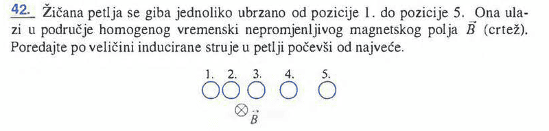

A wire loop accelerates from position 1 to position 5. It enters an area of a homogenous non changing magnetic field B. Rank the induced currents in the loop starting from the biggest
A wire loop accelerates from position 1 to position 5. It enters an area of a homogenous non changing magnetic field B. Rank the induced currents in the loop starting from the biggest. in solutions it says I4>I2>I1=I3=I5=0 but i dont understand why
At the edge of the field region the flux through the loop will start changing. The faster the loop is moving (later in the acceleration) , the faster the rate of change of flux.

shouldnt it then be I5>I4>I3>I2>I1
The picture appears to be in Polish which is a problem for me........
I assume the places where I is zero are regions of constant field (no edges intersected by loop).

its croatian, but i translated the text i just put this for the drawing in case it is not clear from the text
what do you mean that edges arent intersected by loop
Croation.
The loop moves in a region of constant field then ##\frac {d \phi} {dt}=0##
ok thanks
