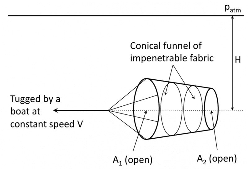

Some classmates and I were talking about the streamlines around a submerged cone being pulled at a velocity ##V##. The picture is attached. Can someone shed some light on the streamlines of this flow, assuming it is inviscid? I take a frame of reference that moves with the cone.
Specifically, would the flow at station 2 be uniform vertically, or would the flow be faster at the exit port forever? Would the streamline profiles be straight upon exit or would they bend a little?
Any insight is greatly appreciated!

Chestermiller said:
What do you think the streamline pattern would look like?
I think the streamlines outside ##A_1## will wrap around the cone and at station 2 all be flat. I think the streamlines in the cone, at station 2, will all be flat too. Before station 2 and in the cone I think the streamlines will adhere to the shape of the wall and condense. I think these streamlines will exit condensed relative to those outside the cone. Since the flow is inviscid, I think streamlines beyond station 2 directly behind ##A_2## will always be closer together than those outside ##A_2##. So a sort of jet.

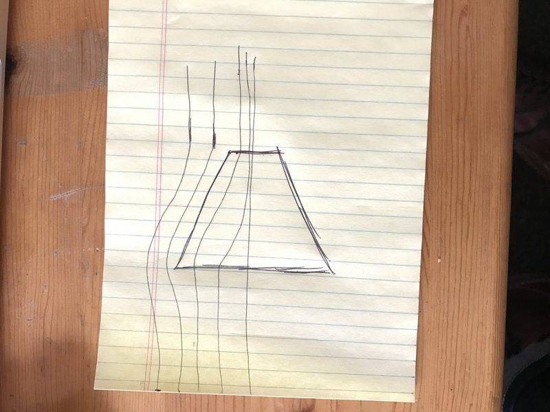

Totally, I've attached one. I've tried drawing all the streamlines equidistant before station 1. Notice after station 2 they are closer together behind ##A_2## then before. Do you agree with this sketch?
  • Hand-drawn pencil sketch on lined paper of a trapezoidal body with several curved streamlines flowing around it from left to right, the lines bunching closer together past the narrow end.
I think that further downstream (after station 2), they will become equidistant again.
What would cause the streamlines to separate after station 2?

Chestermiller said:
Do you believe that the stream function satisfies Laplace's equation for inviscid flow?
I believe the streamfunction does provided the flow is also incompressible (which we assume it is) so yes, I believe the streamfunction ##\psi## follows ##\nabla^2\psi=0##.
Chestermiller said:
What causes the stream lines to even out again downstream of flow over a cylinder?
Yea, I'm not sure about this. Any help?
Also, and I know this is off topic a little, but when deriving Bernoulli's equation from Navier Stokes, how do we know it is only valid along a streamline? At the very end of my derivation, assuming Newtonian, incompressible, inviscid, irrotational flow I have ##\nabla(\partial_t \phi + |\vec{u}|^2/2+p/\rho + g z) = \vec{0} \implies \partial_t \phi + |\vec{u}|^2/2+p/\rho + g z = const.## where I think the constant implies something about which streamline you're on. Also, ##\vec{u}=\nabla \phi##.
Well, if the stream function satisfies Laplace's equation and the streamlines become parallel at large x, then ##\partial \psi /\partial x=0##. Therefore, we are left with ##\partial^2\psi /\partial y^2=0##. That automatically gives equal streamfunction spacing.
Yeah, me neither. It certainly comes out the mathematics (i.e., the vorticity is zero), but it is certainly hard to track down from the Euler equations using physical reasoning. I don't know whether it is worth it spending time trying to do this.
Thanks a ton! This makes sense.
