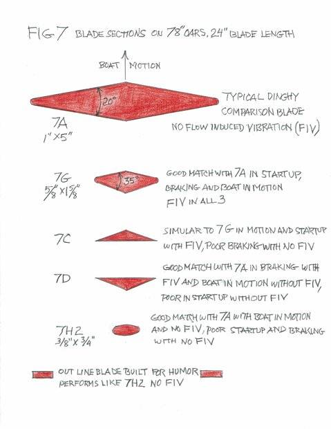

Why would a large reduction in blade area have so little negative effect on the performance of a dinghy oar?
Blades in Photo 6 and Fig 7 can be mismatched as pairs and the boat rowed straight (video 1) indicating some parity with variations at startup, braking, and with/without flow induced vibration (FIV). Fig 2 and 16 show likely blade travel (based on repeat observations). On entry FIV blade is a bluff body in apparent flow of horizontal slippage, minus boat motion, producing FIV for vertical travel where a more streamlined positioned blade, with high aspect ratio and small angle of attack, could generate a favorable lift phase with a good longitudinal component. At each peak of amplitude the FIV blade returns to being a bluff body and repeats the cycle with more cycles in startup, braking and strong headwinds.
Despite the nice construct of Fig 17, seems little evidence of a lift phase in actual rowing as blade exits downstream of entry ( "V. the rowing stroke" from The Physics of Rowing by Chris Pulman ) eodg.atm.ox.ac.uk/user/dudhia/rowing/physics/rowing.pdf Fig 18, with vortices' low pressure at the edges might explain less need for blade area, but outline blade has double the edge length to no noticeable effect.
Extended blade travel of FIV might counter lost blade area in the momentum transfer of a drag driven system. Although non FIV 7H2 (Fig 7) has equal performance to 7A when boat is in motion with less apparent flow, it has poor performance in higher flow of startup and braking where FIV does improve performance as in 7G. Or, could this effect be changes in Reynolds numbers, Fig 14? Seems rowing can be a mental exercise.
FIV is of practical interest since my rowing conditions can be extreme, requiring quick, forceful maneuvers where non FIV thin blades are poor performers, but FIV blades are problematic in grounding out in shallow water. Would reduced amplitude and higher frequency still retain effectiveness? and how to get there?
With 7G section applied to the paddle of a kayak, a lighter craft with less drag, startup and turning by braking were much slower with no vibration, maybe due to the asymmetry of paddling verses rowing, but once boat was in steady forward motion and blade vibrating, it could match performance of pictured paddles, Photo 8 and video 2.
7G blades have been in use for 2 years replacing 7A, they are easy to build, store, carry, use. They generate amusing conversations which have yet to reveal the physics involved, hope this posting will.

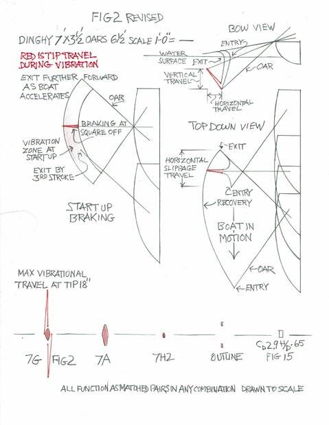

Hand-drawn sketch titled FIG2 REVISED showing rowing oar blade travel in a dinghy, with bow view, top-down view, startup braking diagram, and blade outline comparisons with labels 7G, 7A, 7H2 and FIG15.
Hand-drawn Fig 7 chart of blade sections on 78-inch oars with 24-inch blade length, comparing blades 7A, 7G, 7C, 7D, 7H2 and an outline blade by shape, size and performance notes.

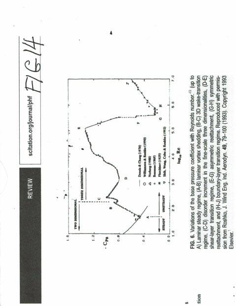

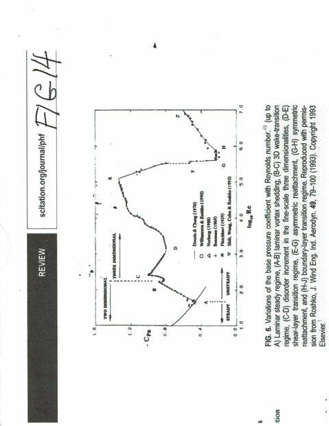

  • Graph of base pressure coefficient (-Cpb) against log10 Re_D, showing regimes labelled A to H from steady flow through three-dimensional wake transition to asymmetric reattachment, with data points from several researchers.

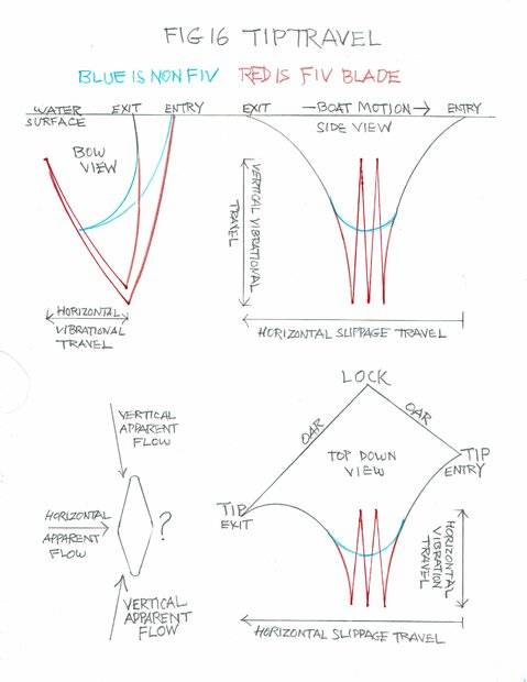

  • Hand-drawn diagram titled FIG 16 TIPTRAVEL, with blue labelled non-FIV and red labelled FIV blade paths in bow, side and top-down views, showing horizontal and vertical travel and apparent flow directions.

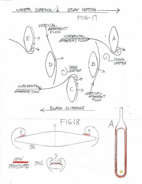

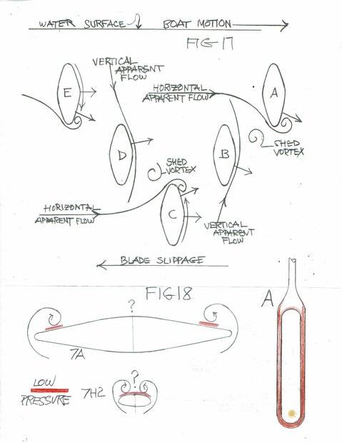

  • Hand-drawn diagram labeled FIG 17 showing apparent flow around an oar blade at positions A through E relative to water surface and boat motion, with vortices and vertical and horizontal flow arrows.

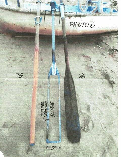

  • Three oars laid on sand in front of a blue-painted boat, labelled PHOTO 6: a wooden oar on the left marked 7G, a metal-framed blade with a rectangular outline section labelled 3/16 x 1/16 and 5 inches, and a dark oar with a broad blade on the right marked 7A.

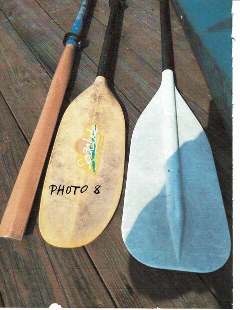

  • Two rowing oars lying on a wooden deck: a wooden-shafted oar with a worn yellowish blade bearing a green and orange logo, and a black-shafted oar with a white blade, labelled PHOTO 8.

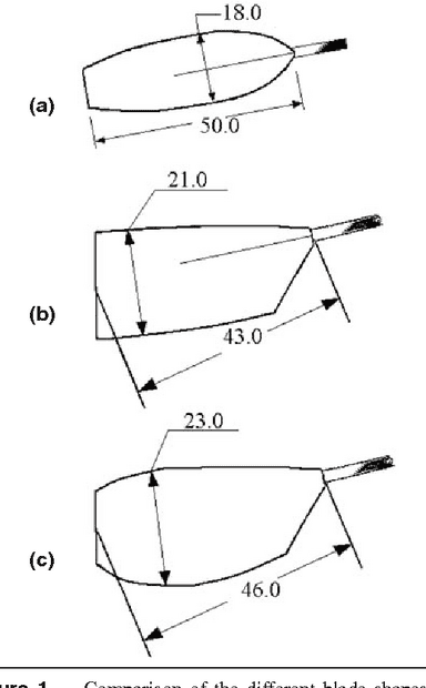

I see where you're going here but there has been a lot of development in rowing blades for racing so that rather implies that the blade supplies a significant amount of torque. I found (Google) many racing blade images and (I'm 60 years behind) was surprised by the shapes of modern oars. They seem to be very asymmetrical. Doesn't that require a constant controlling torque to keep the blade vertical; it can't be locked because it has to feather on the return stroke.
Three line drawings labelled (a), (b) and (c) comparing rowing blade shapes, with dimensions 18.0, 50.0, 21.0, 43.0, 23.0 and 46.0 marked on each.
In sculling (everyday getting places as opposed to rowing races) it is common to move the oars in and out over a fair range in the rowlock (leather sleeve) and even overlap the hands for maneouvering.

Could there be increased lift with more sideways travel of vibration? Found less performance when thin oar blades are feathered. Now row with no rotation and blades fixed perpendicular to water surface. Blade still fallows a good trajectory and is small enough for little need of feathering on return stroke.
Probably not. Vibration or fluttering will spill water faster, and reduce the "grip" of the oar on the water. Maybe the oar surface is ahead of the shaft, so is unstable, spilling water on alternate sides? Maybe the blade is too flat?
Blade is in line and centered along shaft. Blade sections in Fig 7 have descriptions of actions. Vibrations could be Karman street vortex. After entry blade runs deep and even with vibration never disturbs the surface until exit. With width of blade and diameter of shaft being equal, there is less need for feathering on recovering stroke but I referred to submerged feathering for blade travel. The kayak paddle was for comparison since this work was developed on my rowing dinghy which might have unique characteristics.

The minimum blade oar will need to be lighter weight, so the shaft will be elliptical, to reduce bending. The missing blade will also be an elliptical section, but at 90°. The shaft will transform into the blade.
That is a very elegant design but I am still working with rough developmental prototypes. Section 7H2 Fig7 is elliptical, blade cut and welded from 13/8" fence pipe acting as shaft, crude but demonstrates potential of small area blades. This somewhat elliptical section did not vibrate, larger 7G section did. I think there is potential in extended blade travel of vibration. Will try to post videos when server is fixed.

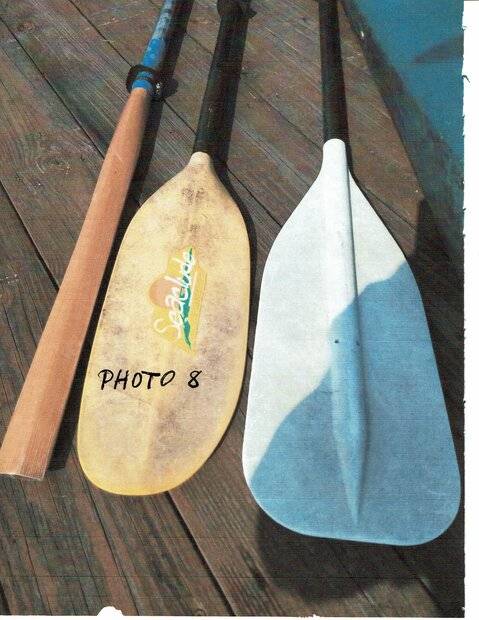

3 different blades (photo 8) propelling the same kayak over same distance in the same time (30+/-1 seconds). If forces are generated by lift, drag or some combination area should count? More info at https://www.boatdesign.net/threads/...tension-through-flow-induced-vibration.68552/ and an entertaining video but no numbers. The subjective is tempered by objective through extended use in various conditions over time. I appreciate the need of measurements especially for communication, could use any detailed advise for this, thank you for your interest.
Are you dealing with a rowing boat or a kayak? They are very different animals.
This work evolved rowing a high drag dinghy with many prototype oars some which are shown above. Changing planforms over time inadvertently lead to less area and structural considerations accidentally lead to vibration. Lesser drag kayak was chosen as a comparison since dinghy might be unique, both oars and paddle used 7G vibrating blades. Kayak had poor performance in startup and turning without vibration but once in forward motion and vibrating (30 sec run) matched other 2 paddles pictured. Vibration can be heard as shaft hits hull in its inboard sweep. I am doing my best!
