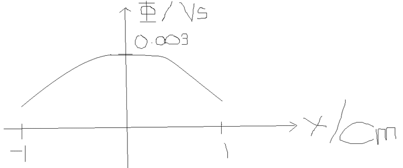

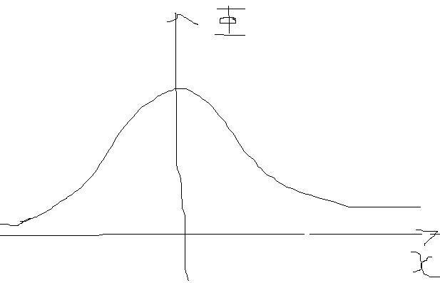

1i)sketech magnetic flux through coil against distance x

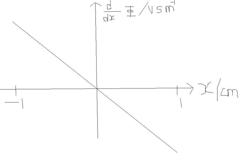

ii)sketch slope of the above graph against x

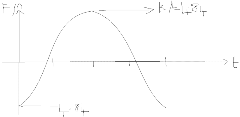

2i)sketch force against time

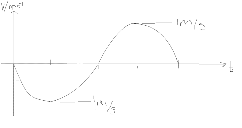

ii)velocity of magnet dx/dt against time

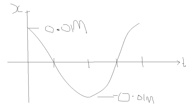

iii)displacement of magnet x against time

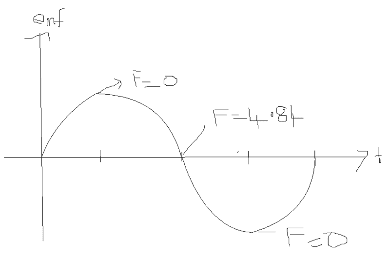

3) sketch a well labelled graph of emf against time show how the various features of emf curve correspond to features on the force curve
emf = - dΦ/dt

for part 1i)
i don't quite get why would magnetic flux change with distance x what is making it very complicated for me is the fact that the length of the coil is longer than the magnet and this is nothing like a solenoid where the field line only diverge after leaving the solenoid for the most part
so any help is appreciated

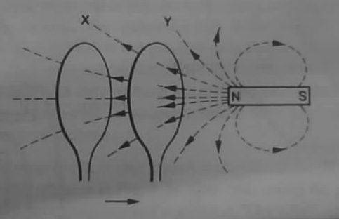

The field lines of the bar magnet curves around from its one pole to the other, north to south, and continues right through the magnet.
The field lines spreads out as they exit the pole and continues outwards.
The induced emf that were measured is the result of sum total of the flux change through each of the coils of the magnet - each coil acts like a little cell and all the little emf's add up to produce the final emf measured.
This means that as the magnet oscillates up and down the flux changes through the individual coils since more field lines enter them when the pole is closer and less when its further away.
In the picture the coil is moving towards the stationary magnet:

okay i see what you are saying but i am still not getting what the sketch should look like because if you shift the magnet up by a bit the magnetic flux leaving the coil through the top will increase but however more magnetic flux will enter the coil through the sides so how to do please help

Anyway, as a start, you should be able to make a rough sketch of the graph of the flux Φ through the coil as a function of the position, x, of the magnet. From that, you can make a rough sketch of dΦ/dx as a function of x.
that is exactly what i don't get please help with that part thanks for your interest and help
What can you say about Φ for very large values of |x|?
Think about starting the magnet far away on the negative x-axis and moving the magnet along the x-axis so that it passes through the coil and moves far away on the positive x-axis. Think about the flux at the beginning and end of this movement. Think about how the flux changes as you move the magnet through the coil. Should the function Φ(x) be an even function, an odd function, or neither?

vishnu 73 said:
but in this case the magnet stays inside and x is very small here
For part 1 of the question, it does not say to plot Φ vs x for just small values of x. Anyway, 1 cm is not necessarily a very small distance. If the length of the coil is 0.5 cm, then 1 cm is not small relative to the size of the coil.
sorry the question i gave is not complete it is
1i)sketech magnetic flux through coil against distance x where x is the distance from the center of mass of magnet to the equilibrium position
ok but anyways does the sketch look like a binomial distribution what i mean is some thing like
Yes, that looks OK to me for the general shape. Φ should approach zero for |x| →∞. (It's probably not an actual binomial distribution or "gaussian".)
From some of the information given in the problem, I think you can get the value of Φ at x = 0.
sorry for the late reply it at x =0 Φ = - 0.003 vs
Yes, except for the negative sign. Your graph shows positive flux at x = 0. Note that the units Vs is equivalent to Tm2 (or Webers, Wb).
Can you sketch the graph of dΦ/dx?

vishnu 73 said:
but then why is it given negative in the question
Faraday's law is often written with a negative sign: ε = -dΦ/dt. So, Φ is the negative of the integral of ε with respect to time.
let me start all over again
is this correct is there any other numericals that i can insert if this is correct
Yes, I think the graph would be approximately a straight line for small x. I don't see how to get any other numerical data for this graph. It would be nice if there were a way to get the slope of this graph, but I don't see any information in the problem that allows you to do this.

2i)\\
f= - kx\\
f = -k Acos(wt)
qn2ii)\\
v = - Awsinwt\\
v_{max} = Aw = 0.01\sqrt{\frac{k}{m}} = 1m/s
x = Acos wt
just realising i could also have put in the time value for one whole period which is 0.065 seconds is there any other numerical values necessary and is the sketches correct thanks
The shapes of the graphs look good. In calculating vmax I don't think you calculated √(k/m) correctly. What value did you use for the mass? Also, your value for the period of the motion does not look correct..

so k is 484
and mass is 4.8/10 = 0.48kg
vmax = 0.317m/s
period is 0.1978 seconds
correct?
Yes, the period is about 0.20 s.
what about my v max is it correct
That looks correct also.
sorry for the late reply here is my next sketch
is it correct i have omitted markings of time
Can you label the tick marks of the time axis of the emf graph with numerical values? I don't think the force values are correctly positioned on the emf graph.
Did you use your relation dΦ/dt = dΦ/dx dx/dt? What is the time dependence of each factor on the right side?
