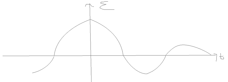

so using the relation
dΦ/dt = dΦ/dx *dx/dt
dx/dt = v

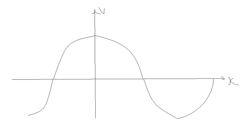

i decided to express v of x
so it is
v = w√(A2 - x^2)
so the graphs looked like this
hence the final dΦ/dt turned to look like this
in other words a damped oscillation
but i am not understanding this
there is a certain level of symetry in the problem in that after every oscillation the emf should be the same at the same position as the before oscillation but in this sketch it seems to suggest that the emf would never reach the same value again as time progresses
I'm not following what you did here. You have ##\varepsilon = - \frac{d \Phi}{dt} = -\frac{d \Phi}{dx} \frac{dx}{dt}##.
From post #21 you have that ##\frac{d \Phi}{dx}## is linear in ##x## with a negative slope (for small oscillations). So, it can be written ##\frac{d \Phi}{dx} = -b x##, where ##b## is some positive number. I don't see a way to determine a value for ##b## from the data given in the problem.
So, ##\varepsilon = -\frac{d \Phi}{dx} \frac{dx}{dt} = bxv##. Or, as a function of time, you have ##\varepsilon (t)= bx(t)v(t)##. You already have expressions for ##v(t)## and ##x(t)##.
