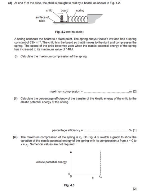

what is percentage efficiency of transfer of KE from child to PE in spring
energy equations
part d- ii and iii
ii) my answer is
300-140/300 *100
ke at y = 300
and spring energy at max compression is 140
iii) e is directly proportional to x^2
so it increases exponentially
is my explanation correct?
hello478 said:
ii) my answer is
300-140/300 *100
I assume you mean (300-140)/300*100%. But 300J - 140J is the energy lost, not the energy retained.
That's quadratic, not exponential. Exponential would be ##E\propto e^x##
so then what would be the energy retained? only 140??
oh yeah, sorry i forgot, i meant quadratic
Yes. What you calculated could be called the inefficiency.
