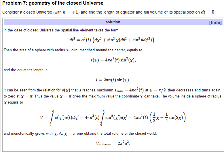

I've searched for a solution on the internet and I found this from a page;
242372
Which is the solution I was looking for exactly.
I just don't understand how they calculated the l=2πa(t)sinx from the dl2.
The sphere is defined by letting ##\mathcal X## constant. The equator also has ##\theta = \pi / 2##. So ##dl = a(t) \sin \mathcal X d\varphi##. You just integrate this over the range of ##\varphi \in (0, 2 \pi)## and get the result.
QuarkDecay said:
and why use that formula of V=∫s(x')a(t)dx'
He is just integrating the area over the radius, which is the definition of volume. The usage of ##\mathcal X'## is because he is integrating, so he uses a different notation, ##\mathcal X'## instead of ##\mathcal X## because he already called the radius ##\mathcal X##.
QuarkDecay said:
V is supposed to be dependent on x,θ and φ right? why only the dx'?
Yes, V is ultimately related to all variables, but you already worked out some of them when you found the area of the sphere, so now the remaining variable is ##\mathcal X##.
