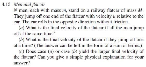

This is a statement
This is an equation
In the question above, the car's final velocity in the first case which is a group of people together jumping off the car, is less than that in the second case which is the same group of people jumping off the car one by one.
My work (subquestion b only):
$$M\Delta v=um \text{(from rocket equation)}$$
$$v_{i+t}-v_i=\frac{um}{M}$$
$$v_{j+1}=v_{j}+\frac{mu}{M_{j}}=v_j+\frac{um}{M+(N-j)m},$$
$$\text{j is the number of persons already jumped}$$
$$v_b=\sum_{j=0}^{N-1}\frac{um}{M+m(N-j)}$$
My questions are as follows:
1. For b, why is ##N-1## the upper bound of the series rather than ##N##?
2. Could you provide an intuition for why the final velocity of the car in b is greater than that in a although both cases expel the same amount of mass?

Leo Liu said:
why is N-1 the upper bound of the series rather than N?
j is defined as the number that have already jumped, so it ranges from 0 to N-1.
Think about how it feels for the jumpers in the two cases. What difference would they notice? It may help to consider the jump taking a little time and analyse forces and accelerations.
I believe that the j th jumper feels jumping off the car harder than the j+1 th jumper does, as both of them need to reach the same velocity in the car's frame and the mass on the car decreases.
Due to my ignorance, I can't really tell how they feel differently in the two cases.
On second thoughts, there is an easier way to think about it. Consider the momentum that each jumper retains in the lab frame. If they land on a frictionless surface, how would they be moving at the end?
I am afraid that my intuition has failed to help me figure out the answer. I could write out several math equations to answer your question, yet it's not the method I have been seeking. Anyway, I would view this phenomenon as an interesting result of the equations to describe the motion. Thank you.
Then try this...
As each man jumps he gives impulse mu to the flatcar and whichever men remain in it. Although those other men gained a share of that, each only gives back mu when they jump. But if they all jump together, the whole of each mu goes to the flatcar.

haruspex said:
Then try this...
I find this answer quite helpful.
If I understand it correctly, the following two equations are the impulses for the two cases.
$$\Delta P_1=\int_i^f F_{men}dt=M\Delta v$$
$$\Delta P_2=\int_i^f F_{men}dt=(M+nm)\Delta v$$
Where n denotes the number of persons remaining on the car.
It is obvious that the second one has the greater impulse than the first one does. I consider the excess impulse comes from the term ##nm\Delta v##. When a men jumping off the flatcar in the second case, the momentum of that term along with the momentum the same as the first one, are released. In contrast, in the first case, the men jump off the car together, which does not result in transporting some momentum to the next guy. So I think this is why the final velocity of the car in the 2nd case is greater.
Is my interpretation valid?
