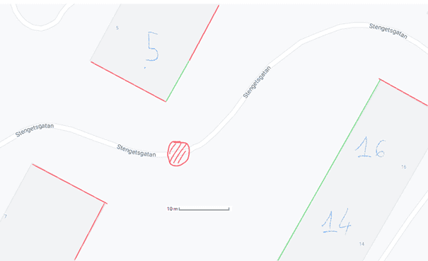

During the winter season, a few of my neighbour had eggs thrown at them as they passed the street. Each attack occurred at the same place (see the red dot on the map) but with no apparent individuals in the vicinity. The egg thrower is tossing the eggs from indoors och probably from some of the windows marked as green on the map. The area painted red designates where the egg cannot have been thrown since there are no openable windows and dense vegetation in the way. The houses number 5 has three floors and the houses 14/16 has 4 floors and are also stationed 2,5m above the road. Figure 1 is to the given scale.
From what location can the culprit have thrown the egg? Since there will be many variables, assume that it is children between the age 8 and 16 who can throw the egg and that they do so at a 45 ° angle. One floor is about 2.5m high.
Herons Formula ##A=\sqrt{p(p-a)(p-b)(p-c)}, \quad p= a+b+c ##
Kinematics formulas
Figure 1. A map of the crime scene.
My attempt:We start by trying to map the possible throwing area from the green marked walls in the figure. The area can be divided into two suitable triangles from each corner towards the red marked crime scene. With the help of Google Earth, the sides of the triangles can be approximated quite well.
Figure 2. The throw area is divided into two parts.​
Observe from the figure that the throw length d must be limited to the interval.
$$11 \space m\leq d\leq 43 \space m \quad(1)$$
Also, note that the throw length from house number 5 is within the range
$$11 \space m \leq d \leq 18 \space m \quad (2)$$
We round off a bit to simplify the calculations somewhat. It is a little more complicated to determine the minimum throw length to house number 14/16. According to Pythagoras' theorem, the shortest distance between two points is the perpendicular distance. So we search for the height of the large triangle. One can calculate the height using Heron's formula. The formula gives the area ##A## for a triangle expressed by the side lengths ##a,b,c## as

Hence the shortest distance from the crime scene to house 14/16 is approximately ##28 \space m##. Now it is obvious ´from figure 2 that the horizontal throw range ##d## for house number 14/16 follows the condition.
$$28 \space m\leq d \leq 43 \space m \quad (9)$$The throw height can also be limited within a range if it is assumed that a floor is ##2.5 \space m##. House number 14/16 will give the maximum height. These houses consist of four floors and are located about ##2.5 \space m## above the ground. The maximum throw height is therefore approximately ##12.5 \space m##, which means that the start height for the thrown egg is within the range.

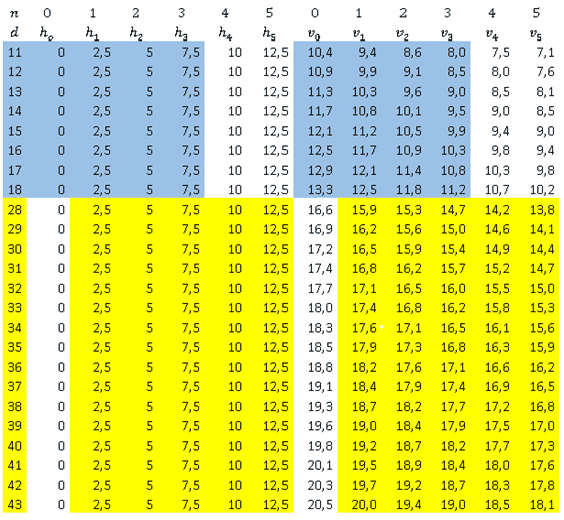

Where ##d## is the distance in the x-direction and ##h## the initial height. The throwing speed in formula (19) depends partly on the height from which the egg was thrown, and partly on the horizontal distance from the crime scene. We will now calculate the starting speed ##v_{i}## for a number of values for ##d## and ##h## within each interval. We make these calculations using Excell to try and identify what the starting speed may be from each house.
Table 1. Each height and velocity is calculated for various values of ##n##. The blue marked part of the table refers to house number 5 for ##d## within the range ##11≤d≤18##. We count from the ground floor of the house to the third floor and are therefore only interested in values of n from zero to 3. The yellow marked part of the table refers to the houses 14/16 where the throw length is within the range ##28≤d≤43##, where we are interested in values on n from 1 to 5.
Note from the table that the distance d affects the required starting speed the most. Since building 14/16 is located further away from the crime scene, these houses require a greater initial velocity . The height does not affect the initial velocity as much, but a larger height decreases the required velocity. By categorizing velocities the from the table above in order of magnitude, one find that they are limited to the following intervals.
$$8 \space m/s \leq v_{i}\leq 20 \space m/s \quad (20)$$
The eggs start velocity from house number 5 are within range
$$8 \space m/s \leq v_{i}\leq 13.3 \space m/s \quad (21)$$
And the start velocity from house number 14/16 within interval
$$13.8\space m/s \leq v_{i}\leq 20\space m/s \quad (22)$$
There is no unambiguous start velocity for the egg. But one can assume that individuals between the ages of 8 and 16 cannot throw the egg at a greater velocity than a professional pitcher in softball. According to a source, individuals in this age group throw with start velocities between 15−25m/s (Anon., 2021) Assuming that the individual throws the egg with full force, this interval is closer to house number 14/16. It is reasonable that the egg was thrown from house 14/16. But this conclusion is not very well based as eggs have a different mass, surface area and strength than the ball that is thrown at softball. However, there are other reasons for drawing this conclusion. For these houses have more floors and at the same time extend over a larger area. Therefore, the houses accommodate more individuals who may have thrown the egg.
If there was a maximum throwing speed from which the egg could be thrown without breaking, the maximum speed could be used to exclude the speed in the table that exceeded this maximum value. The world record in egg throwing seems to be ##99.51 \space m##. The average value for a man's height in the USA is about ##1.77 \space m##. The maximum horizontal range occurs approximately at a throw angle of 45 ° when neglecting air resistance. With these values, the initial velocity for the world record becomes approximately.
$$v_{i}=\sqrt{\frac{gd^2}{d+h}} \approx 31 \space m/s \quad (23)$$
Unfortunately, this value is far above the start velocity in the table and therefore no velocity can be ruled out. There does not seem to be a satisfactory answer as to where the egg may have been thrown from. All houses have possible places from which the egg can be thrown with existing information. In any case, we have arrived at the speed ranges within which the egg must be limited from each house number. If the initial speed had been known, these could have been used to identify where the egg was thrown from. The method used can certainly be improved by dividing d into smaller parts and by avoiding roundings. In this model, we also did not take into account the person's height, but counted from the floor level from each floor. But if you add the height of the person, the height is not much affected. A further shortcoming with our model is the throw angle is a variable and not necessarily 45 °.

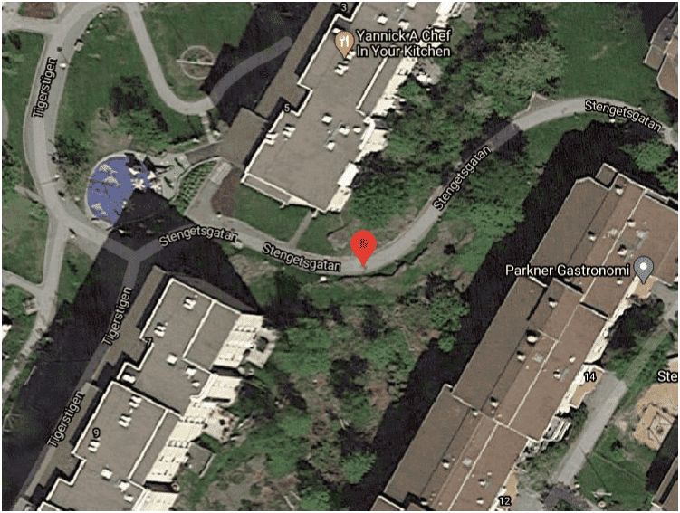

Wow, that is a detailed and involved homework problem! BTW, what do the roofs of these buildings look like? Do any of them have flat roofs with roof access?
berkeman said:
Welcome to PhysicsForums.
Thank's. I normally don't spend this much time on one problem. I am not satisfied with my conclusions, although I did my best anyway. The coordinates for the location at google Earth is 57.679459, 11.883131. These buildings does not appear to have any roof access.
The buildings above and to the lower left appear to have flat roofs, and almost certainly have roof access. Maybe some kids figured out how to get up there, and played "sniper" with the eggs...

Also, I noticed a fair amount of what looks like trees or perhaps bushes around the crime scene. Is it possible to exclude some windows because they don't provide a clear shot to the target? Moreover, to catch a thief you must think like one. What window would you use if you were the perpetrator? Finally, if all else fails, install a couple of surveillance cameras.

I think the key is that the eggs land in one spot and only one spot.
From certain windows, the line of sight of someone visible on the street has a wide range, and eggs could be tossed to land within this wide range minus the distance traveled by the vehicle or walking person when first seen to the time of egg splat, which would be the velocity of the person times the time of flight of the egg ( is it only a walkway perhaps - 2m/sec or for a slow car 10 to15m/sec ). For some other windows, the range is much narrower.
Take the top building.
The person/car can be seen only when passing by the corner of the building from one direction, or when passing by the trees from the other direction. The distance from these locations to the egg splat is about 11 meters. Assuming a 1 sec ready-aim-fire and a 3 sec time of flight ( assuming time of flight you will have to calculate ) a person moves only 8 m walking and a slow car moves 40 m - maybe the cars are moving slower.
For the right hand building, the person/car would be noticed passing by the corner of the right hand building or the corner of the bottom building depending upon direction. Using the same ready-aim-fire and time of flight, a car could traverse what looks like 40 meters from either direction to the splat in the time allocated.
To find the actual window, one has to refine the ready-aim-fire timelength ( assuming it is identical for both directions of car/person ie symmetry ) and the time of flight ( also symmetric ) from a window of a particular height from either building.
