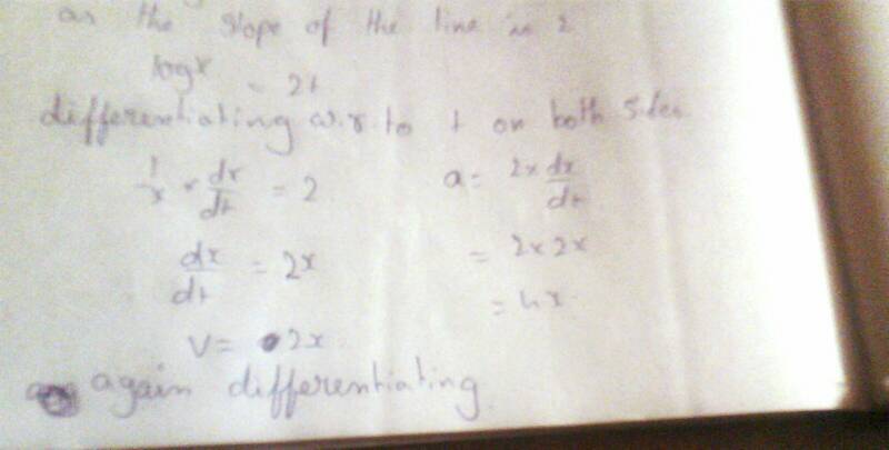

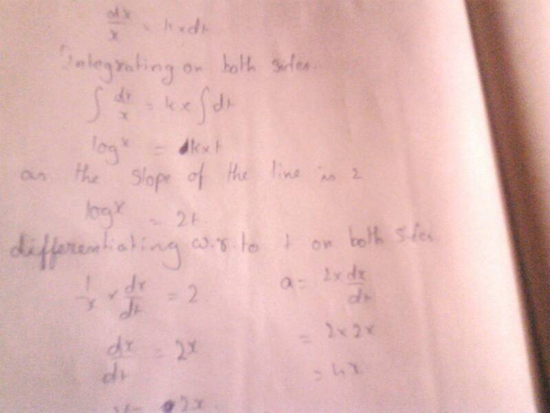

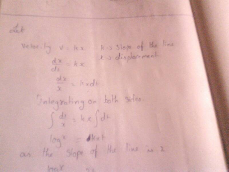

Sir ,
I've tried the sum according to the following attachment .
Actually I have very less knowledge of differential equations.
I came across this problem when I'm studying motion in a straight line chapter.
The answer given is 4x-8
But no solution is given.
Please help me sir.
Thanks in advance!
I just wanted to know how to do the sum!
  • Handwritten derivation: velocity v = kx where k is the slope of the line and x is displacement, then dx/dt = kx, separated to dx/x = k dt, and integrated on both sides giving log x = kt, followed by the note 'as the slope of the line is 2'.

  • Handwritten derivation on lined paper: dx/x = k x dt, integrating both sides gives log x = kt, slope of the line is 2 so log x = 2t, differentiating w.r.t. t gives (1/x)(dx/dt) = 2, dx/dt = 2x, a = 2x(dx/dt) = 2x(2x) = 4x.

  • Handwritten derivation on paper: slope of the line is 2 so log x = 2x differentiating w.r.t. t gives (1/x)(dx/dt) = 2, dx/dt = 2x, v = 2x, then a = 2x(dx/dt) = 2x·2x = 4x, and 'again differentiating'.

OK, from the graph, what is the equation for the velocity v as a function of the distance x? (This is the first step in obtaining the solution).
Chet
Even after trying with that equation I can't get the solution
sylwesh98 said:
V=-2x+4
Take the derivative of this equation with respect to time. What do you get? How is dv/dt related to the acceleration. How is dx/dt related to the velocity?
Chet
I got a=-2v and v = -2x +4 and solving them I got the answer
thank you sir!
