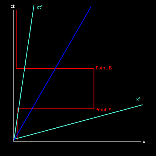

So I look at the Minowski diagrams, and I can understand that moving on the y means moving in time, and moving on the x means moving in space, but drawing some diagrams of my own, I find it impossible to see why it would imply FTL travel. All objects travel either directly on the x (instantaneous jump) or forwards. I can understand why you would have some weird visual effects (seeing yourself jump into hyperspace after the jump), but I cannot understand why it would imply time travel, and have given up all attempts to interpret the Minowski diagrams.
Could anyone help by explaining exactly what would happen if a spaceship was equipped with an FTL jump drive?

As I understand it, when looking at it from the primed perspective, Point A and B shift down the y axis, implying reverse time travel?
cyberdiver said:
As I understand it, when looking at it from the primed perspective, Point A and B shift down the y axis, implying reverse time travel? [/QUOTE]
Don't you mean point A and the point "east" of A?
Here is a labeled version of your Minkowski drawing with a line going just from A to B (the markings along the top and right are for the yellow grid lines):
There is nothing special about this worldline. It's just a stationary object located at x=5 with time going from 3 to 4 (according to the frame depicted with the grey grid lines). Here's another spacetime diagram showing just the rest frame of this object:
Now I use the Lorentz Transformation process on points A and B to see what it looks like in a frame moving at 0.5c with respect to the first frame:
Now you can see that the object is moving at -0.5c and its time and space coordinates are the same as the yellow coordinates in the first drawing.
As dauto pointed out, the FTL occurs when the object instantly moves from its location near x=0 to Point A and then later from Point B back to near x=0.
The bottom line is that the Minkowski diagram does not say anything about whether or not an object can actually travel at FTL as you can draw any lines going any way you want. Normally, people use a Minkowski diagram to depict the rest frames of two different objects traveling at different speeds with respect to each other but that speed cannot be equal or greater than c.
By the way, what is the purpose of the blue line in your drawing?

@ghwellsjr: The blue line is supposed to be a relativistic object, and the light blue lines its Lorentz-transformed frame of reference.
Looking at your diagram, it seems that the origin of the path to Point A (from the frame of the relativistic object) would be roughly -1.5, 3.5, while point A itself is 4, 0.5. That means that the net movement in time is about -3 units. Still equipped with the jump drive, the ship would be able to jump to its past self and stop it from ever leaving in the first place! Out the window with casualty!
I don't know how you arrived at that. Usually, when we talk about an object's frame of reference, we mean one in which it is at rest, meaning its worldline is aligned with the time axis or at least parallel with it so that there is no change in the x-axis as a function of time. You didn't draw the dark blue line aligned or parallel with the light blue ct' line so you need to explain what you mean.
Where did you get these numbers from? I can't figure this out.
cyberdiver said:
...while point A itself is 4, 0.5. That means that the net movement in time is about -3 units. Still equipped with the jump drive, the ship would be able to jump to its past self and stop it from ever leaving in the first place! Out the window with casualty!
Okay, I obviously am misunderstanding these diagrams somewhere with the reference frames. Ignore that.
About the numbers, I assumed that the ship would be jumping from 0, 3 to 5, 3, then from 5, 4 to 0, 4. I then visually estimated the coordinates on the yellow grid, then applied them to the last diagram.
I'm doing something wrong, right?
Ok, I see what you mean now by the origin of the path to point A and you determined the coordinates correctly in the yellow frame and your conclusion is that traveling at faster than the speed of light presents all kinds of problems, correct? Does this answer your question?

@ghwellsjr: So what I did with the Minkowski diagram was right? That the path would bend backwards in time?
Yes, but that just illustrates that two spatially separated events (the endpoints of your so-called "path") that are simultaneous in one frame are not simultaneous in other frames. In some frames one end of your path happens before the other end and in other frames it's reversed. You can have an object such as a rod that stretches along the path that you describe with its endpoints defined by simultaneous events in its rest frame and the spatial distance between the events is the Proper Length of the rod. In other frames the events have no particular significance.
This is not generally the way that FTL is presented. It is usually just an extrapolation of the thought that in a particular frame as a clock moves faster and faster its rate of time passage goes slower and slower until, it is thought, at the speed of light the clock stops and then when it goes faster than light, it starts running backwards. It's not any more complicated than that but since it is an erroneous thought, it is not supported by any Minkowski diagram nor by the Lorentz Transformation on which the diagrams are based.
But if the Lorentz factor is multiplied by i past lightspeed, that isn't really negative time, is it?
The argument that FTL implies back-in-time isn't about applying the Lorentz transforms for a velocity v > c. What the argument shows is that if a rocket (or signal) travels faster than light from point A to point B, according to one frame F, then from the point of view of a second frame F' (moving slower than c relative to F), the rocket arrives at B before it left A.
So the "negative time" is not for the rocket that's traveling faster than light. It's for a second, slower-than-light frame.

cyberdiver said:
Basically, what I meant by 'FTL jump drive' is that it disappears in one place and instantaneously reappears in another. It isn't affected by relativistic effects. If it were affected by relativistic effects, time runs sideways or something.
Cool. So there's no "travel" involved. In fact, you won't mind if I simply destroy all information about the traveler at his starting position and recreate him at his destination. And I will use local mass to do it.
That way we are only talking about FTL transportation of information - not of any mass or charge.
To test it, we'll transport a radio transmitter from Earth to a location 1 light-hour away. And we then verify this be receiving its signal exactly 1 hour after the transport.
While doing this, aliens happen to be cruising through our Solar System and observes our experiment. Because they are traveling at a significant fraction of the speed of light, they may not agree that the radio's departure time matches its arrival times. It may see a delay, or, if traveling in the right direction, it may see the arrival occur before the departure - an apparent step back in time.
When the aliens report this to us, we decide to take advantage of it. We make three copies of our transporter placing them at the ends of an equilateral triangle - 1 light-hour on a side. On our first test run, we simply transport an item from point A to B to C and back to A. The round trip time is almost zero.
Then, on our next test run, we accelerate the devices at B and C so that when they transport in their reference frame, it appears to move back in time in our (point A) reference frame. Several minutes before we initiate the transport from point A, our radio arrives from point C!
