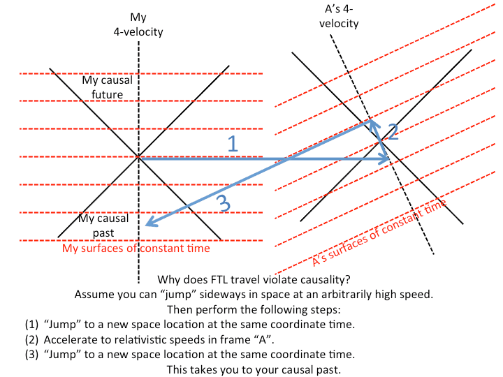

I am looking for some clarification for was is meant by "if you could travel faster than light you go travel backards in time." It seems to be a pop sci-fi reference.
I am 99.99% sure I am correct but would like some clarification from the other members here. I occasionally read that "if you could travel faster than light you go travel backards in time." This statement does not make sense to me and seems to be a misinterpritation of reality.
I will provide an example, let's say I throw a ball to my left and then instantaneously (FTL) travel several miles away with a telescope and look at myself. As far as I am concerned I would see myself start to throw the ball to my left. This is not time travel per se, it is just a delayed image of what has happened due to the time it takes for the light to travel from my previous spot to where i threw the ball to the spot where I ended up after instantaneous moving away to see myself.
True time travel would allow me to remain at the same location and I could concievably then decide to instead throw the ball right instead of left, thus I have "changed" the present if you like and create a paradox. As far as I am aware this is not theoreticaly possible, is that correct?

The crux is here, in the word "instantaneously". If something teleports instantaneously in one frame, then there is another frame where this means that the object appears at the new position before it disappears at the original position. There is also a frame where the object disappears and then it takes some time before it reappears at the new position. This is all due to the relativity of simultaneity. Regardless, if this type of FTL travel were possible, then it would be possible to arrange for having something sent back in time (as in "reappearing in the past light-cone of the disappearance event") by repeating the process in a particular manner.

The events causally connected to you, that is, the events that you influenced in the past or that you can influence in the future are all "time-like" separated from your current location "now", which means that those in the future will remain in the future in any frame, whereas those in the past will remain in the past in any frame, all of that relative to their "now".
This was discussed at Physics Forums a month ago. Nobody found a good link to literature.
If you can do faster-than-light travel at any speed relative to any inertial coordinate frame, then you can travel to your causal past. That is easy to show.
If you can only travel faster than light relative to a single inertial frame, you cannot travel back in time relative to that frame. You cannot travel to your causal past.

You would be able to affect things in your past light cone.
... which would break the assumption of no frame being special.

As @Heikki Tuuri said, if you can travel FTL in any frame, you can show that you can travel to your causal past. I made the attached space-time diagram to show how you would go about it.

If you can travel faster than light then you can affect events in your past lightcone and generate paradoxes (unless one restricts faster than light travel to finite speed in a chosen frame, or some such thing).
However, accelerating to the speed of light is impossible - we cannot describe you doing it. So the paradoxes that would arise if you could do something you can't do, don't bother us.

The technical jargon for this is "tachyonic antitelephone", or "Tolman's paradox", which you can search for.

Let's put it this way, "IF" you could travel faster than c, then our present understanding of the universe predicts that you could travel back to your own past.
This means one of three things :
1. FTL is just simply not allowed in our universe.
2. The predictions based on our understanding are wrong.
3. Causality paradoxes are possible.
Of the 3, the last one is the least likely.
