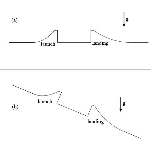

Now I'm not the smartest person in the world...just a snowboarder trying to get some help...so here is the information i have...My ramp is 10ft tall and is at a 35degree angle...my landing is 32feet away...my totally weight is 160 pounds...so how fast in miles per hour do I need to be going at the launch point to land properly at the end?

let me explain...I am going up the ramp at X mph I leave the ramp at a 35 degree angle UP...and I land 32 feet away now what's X?
the other information I though that might need to go into figuring this out was the height of take off and landing as well as my weight
Your weight is not required. A basic calculation gives me 18.76 miles/hour. This is of course not considering any of the other factors like friction, drag, orientation of body etc.

Well I assume you don't want to land right on the edge your landing ramp. I calculated that if you are to land in the middle of your landing ramp (I'm not exactly sure how snowboarders like to do it) you will need to add on 3 miles/hour onto arunbg's result.
Was that 18.76 mph exit speed at the top of the ramp or entry speed at the bottom of the ramp? Plus you'd need a little extra entry speed to compensate for friction losses and aerodynamic drag. Lastly, how do you achieve an accurate speed with a snowboard (unless you're being towed by a snowmobile with a speedometer)? Sounds risky. Ski jumpers use a landing hill, not a ramp. Motorcycle jumpers use landing ramps and crash quite often.
I think everyone is forgetting that gravity is not projected straight downwards if you are using the angles provided by the OP.
Here is a picture to make this clear:
The first pic (a) illustrates what I think you are using to calculate the speed:
And the second pic (b) is how the ramp (most probably) looks in real life!This will cause a very significant reduction in the required speed. In my own snowboarding experience I have even noticed ramps where (for your frame of reference) the ramp slopes steeply upwards, but if you look at it from the 'horizontal' frame of reference it is actually not even going upwards, but only tends to horizontal.
My calculations were based on a setup like fig.a in Nick's post. I also assumed the landing strip was 10 feet below and 32 feet away. The slope of the hill can certainly make attaining required velocity easier.
My calculation was pertaining to the velocity of the boarder at the top of the launch strip.
And this is probably a very inaccurate result for real life scenarios, the exact velocity required depends on so many factors. Again attaining that exact velocity will be a challenge in itself. If you are able to get a velocity greater than required from a given starting height on the hill(referring to fig.a), you can reduce that start height accordingly.
