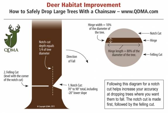

I couldn't see the cuts from the video. How deep do you usually cut the first "V" notch cut? And how close to the "V" do you get with the backside felling cut? It seems like there is resistance to the fell of the upper tree part from the web between the final cut and the "V", no? So it's not like a freefall situation with a simple fulcrum point under the felling tree piece...
https://deerassociation.com/safely-drop-large-trees-chainsaw/
