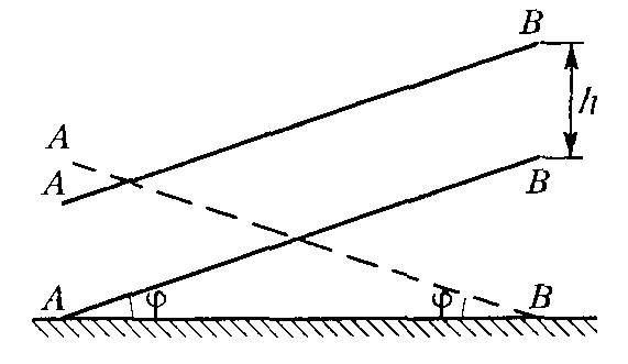

Rod AB of length [itex]2l[/itex], inclined to the horizontal at an angle [itex]\phi[/itex], falls, without rotating, with some height [itex]h[/itex] on a horizontal table and hits the table surface elastically first left, then right end. During the strike the right end, the rod again consist angle with the horizone [itex]\phi[/itex]. Find the height [itex]h[/itex].
Energy conservation law [itex]mgh=I_{CM}\dfrac{\omega^2}{2}[/itex] (1)
where [itex]I_{CM}[/itex] - moment of inertia about the center of mass of the rod.
Motion of center mass [itex]m\dfrac{dv_{CM}}{dt}=mg-N[/itex] (2)
where [itex]N[/itex] - normal reaction, acting on the left edge of the rod.
Rotational motion [itex]I_{CM}\dfrac{d\omega}{dt}=N l cos \phi[/itex] (3)
And now no idea, how to solve.
Of course, the height can be found from the law of conservation of energy. In an elastic collision, the kinetic energy of translational motion partially transferred to the rotational kinetic energy, and the center of mass is not raised at the previous height, but on the other, where the selected zero potential energy. Therefore, in (1) [itex]\omega[/itex]- the final angular velocity, I do not know how to find.
That assumes there's no linear motion immediately after the first bounce. That cannot be true. In order for the two bounces to be symmetric the first bounce must produce an upward movement at the mass centre.
Suppose the bounce involves a vertical impulse J at point of contact. You can write down three equations: linear momentum, angular momentum, energy. You have four unknowns: impulse, linear speed before, linear speed after, angular speed after.
Next, consider the time t from first to second contact. You have two equations: angle of rod at time t, height of right hand end of rod at time t (=0). You now have enough equations to find all the unknowns.

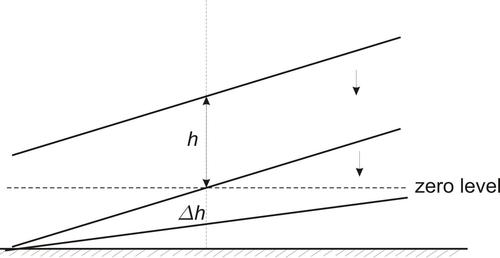

(a)
[itex]\Delta h = vt-\frac{gt^2}{2}[/itex], [itex]\Delta h[/itex] vertical height abter first bounce.
(b)
I always thought that the rod moves as shown. First, gliding over the surface of the left end so that the center of mass is in the same vertical. Then start upward motion, with [itex]\vec v[/itex]. Am I right?
Or the center of mass of the rod stops at zeroі level, and then begins to rise up? I do not understand this point.
sergiokapone said:
(a)
[itex]\Delta h = vt-\frac{gt^2}{2}[/itex], [itex]\Delta h[/itex] vertical height after first bounce.
That's certainly the generic equation, but I defined t as the time to the second bounce. We know what Δh is at the time of second bounce, yes? (Remember, the angle of contact is the same as in the first bounce, just reflected.)
(b)
Yes, the centre of mass stays in the same vertical line. Asking for the height of the end may have put you on the wrong track. What I'm looking for is the relationship between t, ϕ and ω.
If we accept the hypothesis that the center of mass stops at zero level, then:
[itex]\Delta h = v\frac{t}{2}-g\frac{t^2}{8}[/itex], if t - is the time to the second bounce.

No, it doesn't stop at zero level; it must move up. But it does return to zero level at time of second bounce. Its height above the ground is l sin(ϕ) in both cases. Just put Δh = 0 in ##\Delta h = vt-\frac{gt^2}{2}##
During this time t, rod rotated by an angle [itex]\pi-2\phi[/itex].
No it's even simpler than that. Think again.
haruspex said:
above the ground
Ok, your zero's level is in the ground.
haruspex said:
just put Δh = 0 in ...
##t=\frac{2v}{g}##
