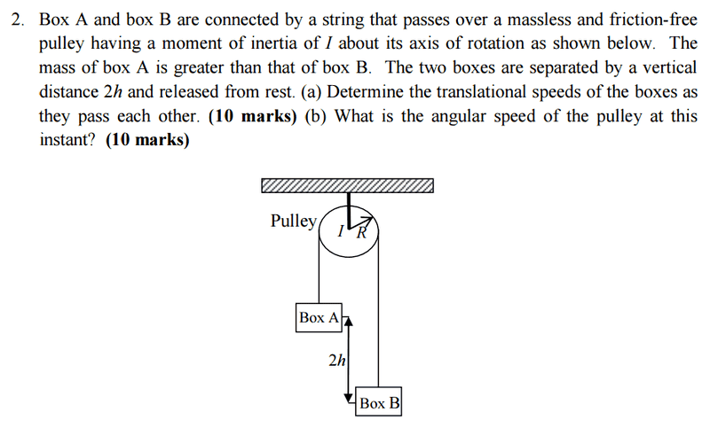

Diagram of a pulley system: a massless pulley with moment of inertia I and radius R hangs from a ceiling, with box A hanging on the left side and box B on the right side, separated vertically by a distance 2h.

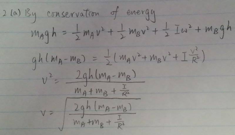

v=rω
conservation of energy
Handwritten derivation by conservation of energy: m_A g h = ½ m_A v² + ½ m_B v² + ½ I ω² + m_B g h, rearranged to v² = 2gh(m_A − m_B) / (m_A + m_B + I/R²) and v = √(...).
I don't know whether it is correct or not, and I am quite confused in part b
it asks the angular speed of the pulley
can I say that v=rω since the pulley and box A,B have a common velocity?
so is ω equal to 1/R*√((2gh)(mA-mB)/(mA+mB+I/R^2))?
but the question is worth 10 marks:H

That all looks right.
