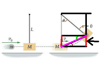

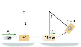

A ballistic pendulum is a common device that is designed to measure the speed of small projectiles. As shown in the sketch on the right, it is composed of an initially stationary metal "cage" which traps the projectile and is suspended vertically by a very light weight rod attached to a low friction pivot. The bottom of the cage is usually equipped with a "pawl" (not shown) which prevents it from slipping backward after reaching it's maximum height. In a particular experiment, the projectile is a steel ball with a mass of 50.0 grams, the cage assembly has a mass of 250. grams, and the length L from the pivot to the center of mass of the entrapped ball + cage = 25.0 cm. After firing, the ball + cage reach a maximum angle from the vertical of 35.0. What was the initial speed 0o of the ball?
Diagram of a ballistic pendulum: a projectile of mass m with speed v0 strikes block M hanging from a rod of length L, then the combined mass M + m swings up to angle θ with speed v = 0 at the top.
Conservation of Angular Momentum
L = r x p
L = Iw
I = MR2 for a thin cylindrical shell
w = v/r
1/2 Iw2 = mgh
L of ball = r x p = .25m * .05kg * v0 = .0125m * kg v0
L of ballistic pendulum + ball = Iw = (.3kg)(.25m)2w = .01875kg * m2w
.0125m * kg v0 = .01875kg * m2w
v0 = 1.5m * w
v0/1.5m = w
1/2 * MR2 * v02/2.25m2 = (.300kg)(9.8 m/s2)(.25m sin35)
1/2 * (.300kg)(.0625 m2)* v02/2.25m2 = .42 kg* m2/s2
.0041 kg v02 = .42 kg* m2/s2
v02 = 102.43 m2/s2
v0 = 10.1 m/s
The correct answer is 5.65, so I'm not sure where I messed up.

Diagram of a ballistic pendulum: on the left, a projectile m moving right with speed v0 strikes block M hanging from a string of length L; on the right, the block swings up to a raised position with the string at angle theta from vertical and height h marked.
I thought that would just be Lsin35, since if sin was 90 degrees, you would be at exactly L

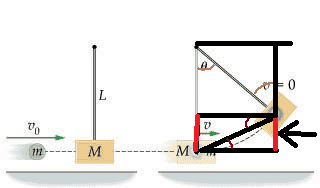

Please check attached image. That pink line is not equal to L, nor is the green angle equal to 350.
See the other attachment. What is the length of the blue line in terms of the given data?

cos theta = adj/hyp
hyp cos theta = adj
L cos 35 = adj for blue line
And then the red line would be L - Lcos35? so .25m - .25mcos35 = .045m?

You got it! :smile:
Replaced that in my equation and got 5.68, which is probably close enough. Thanks for help!
