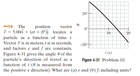

Textbook problem 10 with the position vector r = 5.00t i + (et + ft^2) j and a graph of angle theta in degrees versus time t in seconds, ranging from 20 to -20 degrees over 0 to 20 seconds.
2. The attempt at a solution
I would use the arctan (Position j / Position i) and set it equal to the position vector. Then I would substitute values from the graph to find the variables.
The solution manual, however, takes the derivative of the position vector and then sets it equal to the arctan (Position j / Position i). I don't understand the reasoning behind taking the velocity vector (derivative of position vector) instead of the position vector itself.

In this problem, they're using the symbol ##\theta## to represent the direction of the velocity vector, rather than the circumferential coordinate of the particle. This is an unfortunate choice, since it certainly causes confusion. They should have called it something else, like ##\phi##.

Good point by Chet: I am one of the shallow readers who got confused... o:)

Don't beat yourself up. It was a poorly posed problem.
