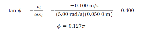

A 200-g block connected to a light spring for which the force constant is 5.00 N/m is free to oscillate on a horizontal, frictionless surface. The block is displaced 5.00 cm from equilibrium and has an initial velocity of vi = -0.100 m/s. Find max velocity.
tanφ = 0.4
position and velocity expressions for the initial conditions
1) x(0)=Acosφ = xi
2) v(0)=-ωAsinφ= vi
Dividing 2nd equation by equation results in:
-ωAsinφ/Acosφ = xi/vi
tanφ = xi/(-ωvi)
tanφ = 0.4
And here they (the textbook) got φ = 0.127π, This is where I need help please and thank you.
When I see tanφ = 0.4 in order to solve for φ, I would take the arctan of both sides.
That would give me φ = arctan(0.4) = 21.80140949°
Now to actually finish the problem I can find the amplitude by using cos(21.80140949°)
i.e. A = xi/cosφ = 0.05m/cos(21.80140949°) = 0.54m
and I can therefore find the max speed by doing:
vmax = ωA = (5rad/s)(0.54m) = 2.7 m/s
I don't understand how 0.127π was acquired. Going back to:
If I want to turn this degree into rad, then I multiple by π/180
φ = 21.80140949(π/180) = (21.80140949/180)π = 0.12111894π
Which obviously 0.12111894π =/= 0.127π
So even though I can still get the right answer for the actual question by using my cosφ, I don't understand how the textbook got their answer of what φ is. Any help would be appreciated please and thank you.

Hmm, this got me into spinning around in 360 deg or should I say ##2\pi## rad.
Indeed it seems to be ##\phi=0.121\pi##. Probably a typo in book (that 7 meant to be 1) or some sort of rounding error.
Btw , you seem to have made two typos too, you should have $$\frac{\omega A\sin\phi}{A\cos\phi}=\frac{v_i}{x_i}$$ and $$\tan\phi=\frac{v_i}{\omega x_i}$$.
And I also made a typo in the above lol, I forgot a minus sign.
The book has a typo regarding the minus sign too.

er sorry, the minus before the final result for ##\tan\phi## shouldnt be there, since the initial velocity is given as minus. it is -(-0.1)=0.1
oops no there are two minus ehehe my fault sadge.

But there is a confusing typo in post #1:
1) x(0)=Acosφ = xi​
2) v(0)=-ωAsinφ= vi​
Dividing 2nd equation by equation results in:​
-ωAsinφ/Acosφ = xi/vi (*)​
tanφ = xi/(-ωvi) (*)​
tanφ = 0.4​
In the two equations I have starred, the division on the RHS has been inverted. The final line is correct.

@haruspex you agree that it indeed should be ##0.121\pi## right?
The only way I can see for ##0.127\pi## to happen is if we take the very raw approximation of ##\pi## as 3.1

Why find the angle at all?
##v_{max}=\omega x_i\sec(\phi)=\omega x_i\sqrt{1+\tan^2(\phi)}=(5)(0.05)\sqrt{1.16}=0.27##.
Should be 0.054m, no?

The only way I can see for 0.127π to happen is if we take the very raw approximation of π as 3.1
No, that doesn't make 0.127π right; it only means that the error (0.127 instead of 0.121) is slightly ameliorated by a second error. Slightly, because 0.127 is 6% over whereas 3.1 is only 1% under.
But it makes barely any difference to the max velocity because the amplitude is not much more than 0.05m anyway.
