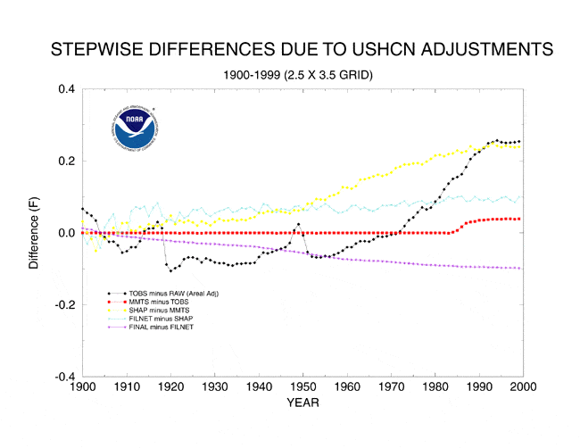

Version 1 of the USHCN is what I am personally most familiar with, since I did a number of experiments on it myself, and have written various programs to process and use that data. To assist users like me, the version 1 data is still available. A description of version 1 processing is available here: United States Historical Climatology Network (USHCN) Version 1 (at NCDC).
There are some differences in the processing steps of version 1. It uses the same basic steps, but the algorithms are a bit different. In this case, an additional final step was applied that explicitly corrects for urbanization; in version 2 this is now addressed in step 3.
The version 1 data description includes a graph in which the effect of the urban adjustment step is made clearly visible; it is the purple line at the bottom of the graph. This figure is linked from the NCDC page for version 1.
The effect is to alter the trend over the century by about 0.1 degrees F. Note that all these steps are applied to each individual station. In particular, for version 1 you can see the urbanization step individually at each station as well. The effects are not uniform, of course; the purple line in the graph above is merely a measure of the impact of all adjustments on the USA combined temperature.
