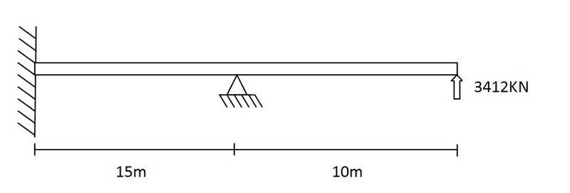

Just a really basic question, say you have a shaft about 25meters long and at the end of the shaft there is a force of 3412KN, what is the torque of the shaft?
T = F*d
does that mean that T = 3412*25 = 85300KNm
is that right?

if the force is perpendicular to the shaft, then yes :smile:
Just remember that the 'd' in the equation is distance (lever arm length) not diameter. Unless the force is a couple the d (distance) is equal to half the diameter of the shaft. You've referred to a shaft, which to me means it rotates about its longitudinal axis.
Or is it a 25 m long lever.
You really haven't described how the shaft is supported and how the load is applied.
For example, a shaft 25 m long probably has some supports/bearings along its length.
What kind of shaft? Is it used for power transmission? Is it circular (and what is its diameter?) With regard to the load, is it applied in such a manner that it will bend the shaft or twist it? If the load will twist the shaft, then that is usually referred to as a torque. If the load is applied such that it will cause the shaft to deflect from its original centerline, this is usually referred to as a bending moment.

Here is the image of how it looks and this is a shaft. So there will be torque applied on the length of the shaft.
So eventhough it has a support in the centre, does T = 25*3412 ?

You have a bending moment created at the fixed end of the shaft by the vertical load applied at the free end. A torque is usually taken to mean a moment which twists the shaft about an axis running along the length of the shaft.

ah, that's what i thought :smile:
yes, the torque about a particular point is the same no matter what other forces are present
of course, when you calculate the actual strain or acceleration or whatever, you'll have to add the torque of the reaction force at the centre support :wink:
