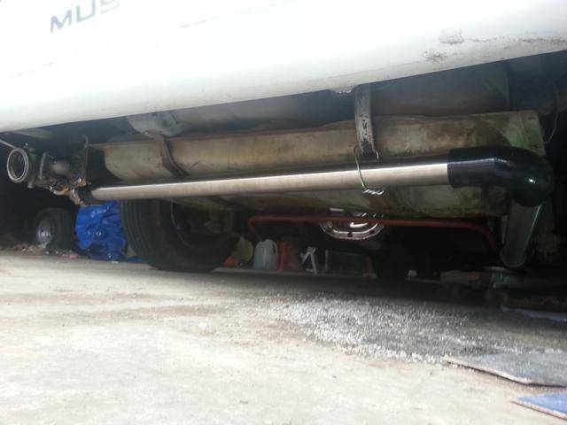

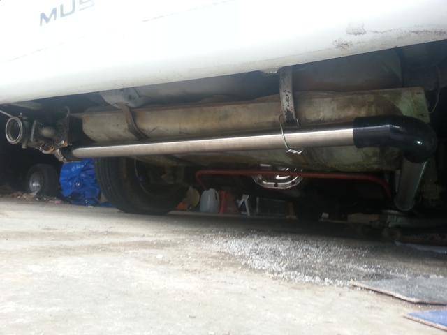

I've been searching but i can not find the answer. This is for my turbocharged car. I just fabricated a rear turbocharger at the back.
Really not sure how to word this,sorry.
Question 1:
So my car produces 26Hg/in vacuum at the engine. About how much pressure drop per foot is expected?
The factors involved are a 2" inner diameter pipe that is 12foot long.
I think i can get an approximate guesstimate on Boost (positive pressure).
Thanks , people. I saw some charts online but they only dealt with water and CFM. I figured a smarty pant or two would know something about this here.
Thanks again. :)

I may just have an air leak as i have not yet clamped(sealed) the silicone couplers down yet. A boost/vacuum gauge connected to the turbocharger only showed .5 hg in . I will find out soon if a leak is the culprit but at the same time i am wondering how far a negative pressure can travel before it stops registering on a meter.
In this case i am using about 12 feet of 2" pipe from front, side, to back. With a max vacuum of 27 at the engine.
Thank you for responding.

I missed your post, sorry about the delayed response. Your assumption is correct, the vacuum is being measured at the engine at idle and i was trying to measure from the turbo at the end of the 12ftx2" pipe(it has a port for the gauge hose). I may either have air leaks at the couplers(where the pipes join and have a bend) and/or i haven't had a chance to let the pressure lag catch up to the gauge. When i "blip" the throttle the gauge reads 1in vacuum. I may need to test while driving.

Just wanted to say i put a shop vac in the end of the 12ft pipe.. (also tested the shop vac and it showed about 10HG/In)
the result: the lag is virtually non existent! It even spools the turbo!
Amazing to me. I may be one of the very few who can actually prove rear-mount turbo lag is a MYTH. If you get the right size A/R and trim turbocharger of course.

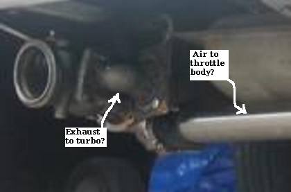

Here's the picture i was working from, top left corner of his
Vacuum for all practical purposes ends at the throttle body butterfly valve. Which i assume is at engine end of his 12 foot pipe not the turbo end.
A question well stated is half answered. Maybe he'll clarify his question.
old jim

I cannot even understand where his long pipe goes or what the turbo is supposed to be doing. He has refused three times to answer my simple question and I really suspect there is some PM process that's planned here. It appears that it is not working for him and he is trying to explain it in terms of a 'leak'. I suspect it's just loss in the system which you always get when you try to pull yourself up by your thermodynamic bootstraps.

To make any sense of his questions i have to assume it's a plain vanilla turbocharger, exhaust driven turbine , with centrifugal compressor on other end of same shaft to raise pressure of air en route to throttle body.

If the OP had said that, for some reason, he's putting a turbo right at the back of the car and wants to know why it's not working as well as if it was right on the manifold then there would have been no problem. He has never (affaics) made that clear - or the reason for the odd siting. That's why I was asking random questions in order to decode what he was writing. I'm really not sure whether any of the replies he has been given will actually help significantly and there has been no feedback about
There is enough turbo delay in the conventional position and there can only be a further delay due to the delay in pressure build up (and drop in temperature?) in the volume and length of the pipe. And then there is pressure drop for the fresh air going back to the inlet. This was such a strange scenario that I assumed there must be more to it. There is no reason why that confusion couldn't have been sorted out after my initial question.
I've heard of that. With today's crowded engine compartments it makes for an easier amateur installation.
Here's the better way to do it but as you see it's non-trivial.
I think the OP confused manifold vacuum with the ever so slight vacuum that would exist between the throttle body and turbo. That is my assumption anyway. Other than the confusion of 26 inches of vacuum at the engine and .5 inches of vacuum at the turbo I don't think the OP was wondering why it 'didn't work'. I don't think anyone can say that it doesn't work. While I had not heard of people putting turbochargers at the back of the vehicle, this does not surprise me. So what if there is 12 feet of pipe on the intake? So what if exhaust has cooled some by the time it reaches the turbo thus yielding less energy? I think it can be assumed that it is a compromise but it is not in my place to point out any more than that.
