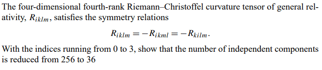

How many independent component does a tensor have?
Tensor analysis.
It's a 4th-dimensional 4th-rank tensor so at first we have ##4^4=256## components.
According to the book, Given that ##R_{iklm}=-R_{ikml}## 256 components reduces to 96. But I cannot see how.
For one pair of i,k 16 components are dependent. We have 12 pairs of i,k(for ##i≠k## becsuse for i=k tensor's components should be 0) so 256 should reduces to ##256-12*16=4*16=64##.Thanks for your help ...
We have 16 independent combinations of ##i,k##. For each such combination, we have an antisymmetric tensor ##R_{..lm}=-R_{..ml}##. ... That gives us ##96## components.

MatinSAR said:
The problem is that I cannot see why.
The antisymmetric tensor has 6 independent components. That is, 6 for each one of 16 combinations of ##i,k##. Total: ##16 \times 6=96##.

At first we have 256 independent components, using ##R_{iklm}=-R_{ikml}## 256 reduces to 96.
Then using ##R_{iklm}=-R_{kilm} ## 96 reduces to 36. Am I right?

Consider the rank-4 product ##P_{iklm}=A_{ik}B_{lm}## of two arbitrary rank-2 tensors ##A_{ik}## and ##B_{lm}##. Each tensor ##A## and ##B## has in general ##16## components, so the product ##P## starts with ##16\times 16=256## distinct components. Now impose the two independent antisymmetries:$$P_{iklm}=-P_{kilm}\Rightarrow A_{ik}B_{lm}=-A_{ki}B_{lm}\Rightarrow A\text{ has 6 components}$$$$P_{iklm}=-P_{ikml}\Rightarrow A_{ik}B_{lm}=-A_{ik}B_{ml}\Rightarrow B\text{ has 6 components}$$So the two antisymmetries together give ##P=A\times B## a total of ##6\times 6=36## independent components. The same argument applies to ##R_{iklm}##.

Hello. I've thought about your suggested method. What I've understand is that because of ##P_{iklm}=-P_{kilm}\Rightarrow A_{ik}B_{lm}=-A_{ki}B_{lm}## A can only have 6 independent components but components of B are unaffected. So till now we have 16*6=96 independent components.
After applying ##P_{iklm}=-P_{ikml}\Rightarrow A_{ik}B_{lm}=-A_{ik}B_{ml}## Which does not affect A But affects B, B can have only 6 independent components. Applying both gives us a 6*6 matrix with 36 independet components. Am I right?!
