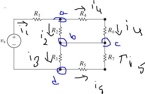

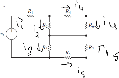

From this circuit diagram assume Vs and all resistors are known.
How many independent equations can be written using KCL?
KCL
Circuit schematic with voltage source vs on the left feeding resistors R1 through R7 in a network, with handwritten branch currents i1 to i5 and arrows showing assumed current directions.
I think there are 4 essential node. So we can write 3 KCL independent equations.
  • Circuit schematic with voltage source vs and resistors R1 to R7, with handwritten currents i1 to i5 and nodes a, b, c, d marked in blue.
Well, we can't achieve the steady state in zero time, theoretically there will be a small time during which the potentials at b and c are not the same, so there will be current through the branch bc till the potentials are the same.

And do you really think that was the intent of the problem? Is that the kind of thing you would put in a problem for beginners?

Ehm, nope I certainly don't think that was the intent of the problem. However sometimes beginners can have advanced concerns, and maybe that's what happened here with our friend @anonim .
