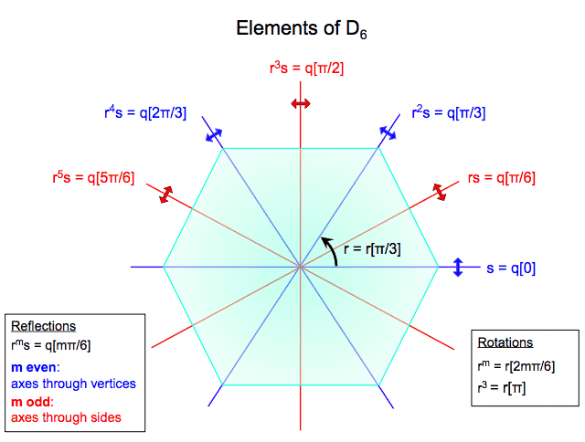

Take a look at $D_6$:
The axis of symmetry of $s$ in this picture goes through $2$ beads.
The axis of $rs$ goes through $0$ beads. (Thinking)
  • Diagram titled Elements of D6 showing a regular hexagon with its six reflection axes and rotation labels: r = r[pi/3], s = q[0], rs = q[pi/6], r^2 s = q[pi/3], r^3 s = q[pi/2], r^4 s = q[2pi/3], r^5 s = q[5pi/6].

I got stuck right now... Isn't $m$ constant in this example, $m=6$ ? (Wondering)
How can we take cases if $m$ is odd or even? (Wondering)
I'm afraid $m$ has a different meaning in the picture. (Worried)
In the picture the number of beads is $6$.
And $m$ represents what we called $i$, the number of rotations that we apply.

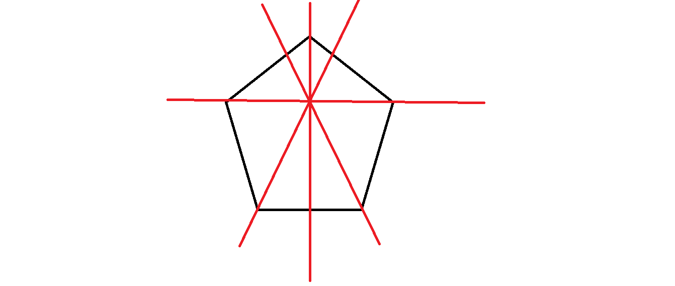

It is of the following form:
right? (Wondering)
right? (Wondering)
The vertical line is an axis of symmetry with 2 vertices to the left and 2 to the right.
However, the horizontal line has 1 above and 2 below. (Worried)

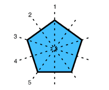

The picture should be like:
There are 5 axes of symmetry, each intersecting with 1 bead. (Thinking)

I like Serena said:
The picture should be like:There are 5 axes of symmetry, each intersecting with 1 bead. (Thinking)
Ah ok... I see... (Thinking)
So, when we have an odd number of beads, there are $k^{\lfloor \frac{m}{2}\rfloor+1}=k^{\lceil \frac{m}{2}\rceil}$ necklaces that stay unchanged under a reflection, or not? (Wondering)
And when we have an even number of beads, there are either $k^{\frac{m}{2}}$ necklaces, when we rotate by an odd $i$, or $k^{\frac{m-2}{2}+2}=k^{\frac{m+2}{2}}=k^{\frac{m}{2}+1}$ necklaces, when we rotate by an even $i$ that stay unchanged under a reflection, right? (Wondering)
