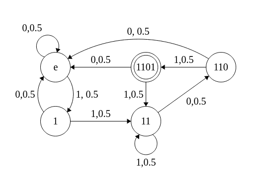

member 428835
Hi PF!
Given a die with probability ##p## for heads, how many flips to achieve HHTH?
The method I was thinking is Markov chains: $$E = (1-p)(E+1)+p(1-p)(2+E)+p^3(3+E) + p^2(1-p)^2(4+E) + p^3(1-p)4$$ and solve this for ##E##, which implies 30 flips on average for a fair sided coin. My thought process was to find the expected number of tosses for H, HT, HHH, HHTT, HHTH respectively (each separated by a sum ##+## respectively).
Is this correct? If so, is there an approach to this using expected value and infinite sums?

I think that the Markov chain is the proper way to approach this. Suppose that we already have HHT. Then the probability of success versus failure on the next toss is very different from having HHH. IMO, with all those kinds of conditional probabilities to deal with, a Markov chain is best. And if it gives a different answer from the simpler approach, then it proves that the simpler approach was wrong.

Your Markov process should have a state where the string ends in "HH". Another "H" occurring in that state should keep you in that state. Are you doing this with a transition matrix?

A simple approach won't work for the following reason. Let's assume ##p = \frac 1 2##. The probability of success after four tosses is ##\frac 1{16}##. But, a failure takes a variable number of tosses and leads to two different scenarios for the next attempt.
If you fail by getting ##T## or ##HT## or ##HHTT##, then you are back to the same starting position. You still have to calculate the expected number of tosses for these failures. Although that's not too complicated.
If, however, you fail by getting ##HHH##, then you are starting the next attempt with ##HH## and only need ##TH## to succeed on the next attempt.
So, it's not a simple case of having success or failure, then starting again. Effectively two different games with different probabilities of success and different expected lengths are interwoven.
That said, it should be possible to get an answer by elementary means.
Here's the structure you need.
We define game 1 as trying to get ##HHTH## in four tosses. There are three relevant probabilities:

I've found a slighty better variation of the above.
First, we look at all the ways to get back to the starting state. These are:$$T, HT, HHTT, HHHTT, HHHHTT \dots$$The probability of this is $$P_1 = \frac 1 2 + \frac 1 4 + \frac 1 {16} + \frac 1 {32} + \dots = 1 - \frac 1 8 = \frac 7 8$$We also need the expected length of this scenario, conditional on it happening. We have:$$E_1 = \frac 8 7[\frac 1 2 + \frac 2 4 + \frac 4 {16} + \frac 5 {32} \dots] = \frac 4 7[
1 + \frac 2 2 + \frac 4 {8} + \frac 5 {16} \dots] = \frac 4 7[4 - \frac 3 4] = \frac{13}{7}$$Where I've used the binomial expansion$$\frac 1 {(1-x)^2} = 1 + 2x + 3x^2 + 4x^3 + 5x^4 \dots$$with ##x = \frac 1 2##.
In other words, there is a probability of ##P_1 = \frac 7 8## of returning to the starting state, with an expected length of ##E_1 = \frac{13}7## tosses.
Next we look at all the way to get ##HHTH## without returning to the starting state. These are:
$$HHTH, HHHTH, HHHHTH, \dots$$The probability of this is:
$$P_2 = \frac 1 {16} + \frac 1 {32} + \frac 1 {64} \dots = \frac 1 8$$And the expected length conditional on this happening is:$$E_2 = 8[\frac 4 {16} + \frac 5 {32} + \frac 6 {64} \dots] = 4[4 - 1 - 1 - \frac 3 4] = 5$$Now we effectively have the binomial trials scenario we want: there is a probability of ##P = \frac 1 8## of success, hence an expected number of ##7## failures before the successful trial. The expected number of tosses is then:
$$E = (7 \times E_1) + E_2 = (7 \times \frac {13}{7}) + 5 = 18$$

One advantage of using Markov chain modelling is that you don't have to hunt for the right way to approach the problem as you did in #17: just follow the right steps and you get to the right answer (and for some problems get to answers that are difficult to achieve by first principals analysis).
If you are interested in looking at the Markov chain approach this Cambridge University course material provides both an excellent introduction to the subject and a number of example problems which are comparable to the one in the OP: http://www.statslab.cam.ac.uk/~rrw1/markov/index.html
Don't get tricked into modelling many states for partial strings such as "HHTT", the only states you are interested in are ## { 0, H, HH, HHT, HHTH } ##. The first and last rows of the transition matrix should look like
$$ \begin{bmatrix}
q & p & 0 & 0 & 0 \\
\dots \\
0 & 0 & 0 & 0 & 1 \\
\end{bmatrix}
For a general probability ##p## of getting heads we have:
$$E = \frac{1 + p^2 - p^3}{p^3(1-p)}$$Which agrees closely enough it seems with my revised Python simulation.

A simpler approach is to relate the expected values using the transitions. If we have states ##S_0, S_1, S_2, S_3## to be the starting state, ##H, HT## and ##HHT## respectively and ##N_i## to be the expected number of tosses starting from the ##i##th state, then we can interate through the options as follows:
$$N_0 = 1 + \frac 1 2 N_0 + \frac 1 2 N_1$$That's because after the the first toss we must, in general, have reduced the expected number by ##1## and are now in a 50-50 split of ##S_0## and ##S_1##. This gives:
$$N_1 = N_0 - 2$$Similarly:
$$N_1 = 1 + \frac 1 2 N_0 + \frac 1 2 N_2$$Giving:$$N_2 = N_0 - 6$$And:
$$N_2 = 1 + \frac 1 2 N_3 + \frac 1 2 N_2$$Giving:$$N_3 = N_0 - 8$$Finally:
$$N_3 = 1 + \frac 1 2 N_0$$Giving:$$N_0 = 18, \ N_1 = 16, \ N_2 = 12, \ N_3 = 10$$
