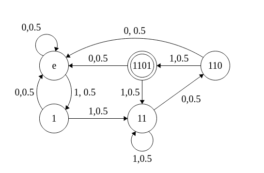

The results are giving me 18 coin tosses on average. Is my programming wrong or is my calculation in the other post wrong (or maybe both are)?

I used a completely independent program to do a few simulations , each of 10 million strings, and got an average of 18 (+-0.005), counting the characters in the termination string, "HHTH".
I used this Perl program:
Perl simulation of 10 million strings to get average length to HHTH:
$numTrials=10000000;
@chars = ("H", "T");
foreach $i (1..$numTrials){
    $string='';
    $count=0;
    while( $string !~ /HHTH/){
        $ran = int(rand(2));
        $char = $chars[$ran];
        $string = "$string$char";
        $count++;
    #    print "count=$count string=$string\n";
    $totCount += $count;
$avgCount = $totCount/$numTrials;
print "avgCount=$avgCount\n";
PS. In my opinion, it is not unusual for simulations to get answers much more easily and reliably than by using analysis. So I would go back and check your analysis.

Here's a non-Monte-Carlo method. I keep track of the likelihood of each state after every coin toss.
I iterate for 1000 tosses:

Here's my plodding Python code:

The "other thread" is interested in a variation of this program that handles unfair coin tosses.
For a probability of head being 0.1 (instead of 0.5), the expected number of tosses climbs above 1121.

The other thread was locked, but I calculated it as a Markov process like @FactChecker suggested based on this link.
https://mpaldridge.github.io/math2750/S08-hitting-times.html
Here is the Markov process I came up with.
The hitting time from state ##e## to state ##1101## is
\begin{split}
\mu_{e,1101} &= 1 + 0.5 \mu_{e,1101} + 0.5 \mu_{1,1101} \\
&= 1 + 0.5 \mu_{e,1101} + 0.5 ( 1 + 0.5 \mu_{e,1101} + 0.5 \mu_{11,1101} ) \\
\end{split}
Need to calculate ##\mu_{11,1101}## in terms of ##\mu_{e,1101}## to continue.
\begin{split}
\mu_{11,1101} &=1 + 0.5 \mu_{11,1101} + 0.5 \mu_{110,1101} \\
&= 1 + 0.5 \mu_{11,1101} + 0.5 ( 1 + 0.5 \mu_{e,1101} ) \\ &= 3 + 0.5 \mu_{e,1101} \\
\end{split}
Now substitute.
\begin{split}
\mu_{e,1101} &= 1 + 0.5 \mu_{e,1101} + 0.5 ( 1 + 0.5 \mu_{e,1101} + 0.5 ( 3 + 0.5 \mu_{e,1101} ) ) \\
&= 2.25 + 0.875 \mu_{e,1101} \\
&= 18 \\
\end{split}
