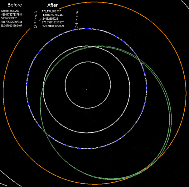

Earth boosted 2005YU55's semimajor axis by about 2 million km. It reduced its inclination from about a half a degree to about a third of a degree.
In this image, the green orbit is 2005 YU55. The interior one is before, the exterior one is after.
Thank you for answering my question. :-)

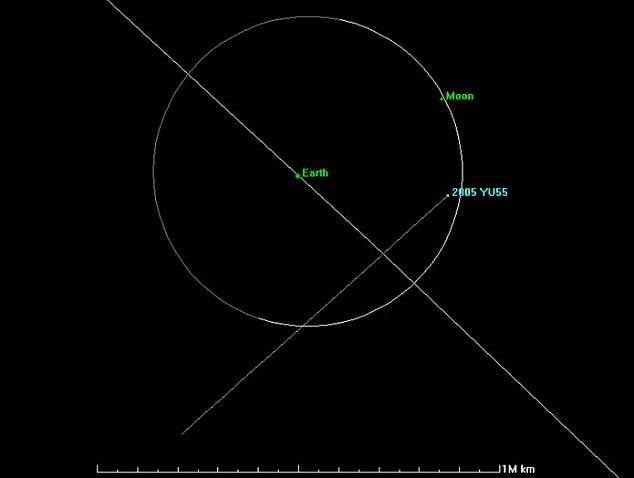

This gif makes a lot more sense when comparing it to
Tony's pic
[PLAIN]http://upload.wikimedia.org/wikipedia/en/c/c5/2005_YU55_approach_8-9_November_2011.gif

Change - like before and after. Tell me that you don't see it with the following image.
The meteor was "sling-shot" when passing by Earth. Space probes use Jupiter to "sling-shot" to add speed and change direction.
What -I- don't see is how this pretty picture indicates a changed orbit.
What -you- don't see is the fact that orbits are never the same perfect ellipses. Doesn't happen.
So, what your picture shows is just a normsl, pretty ordinary orbit.
Griz maybe you missed this post. The inside green circle represents the orbital characteristics of the meteor before it was "sling-shot" by Earth. The outer green circle represents the new orbital characteristics of the meteor. The Earth change the direction and the speed of the meteor via gravitational attraction.
