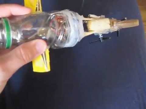

Stevethesub said:
For example say the sub had the volume of 10,000 cubis feet
OMG :bugeye: I thought about somthn like this
