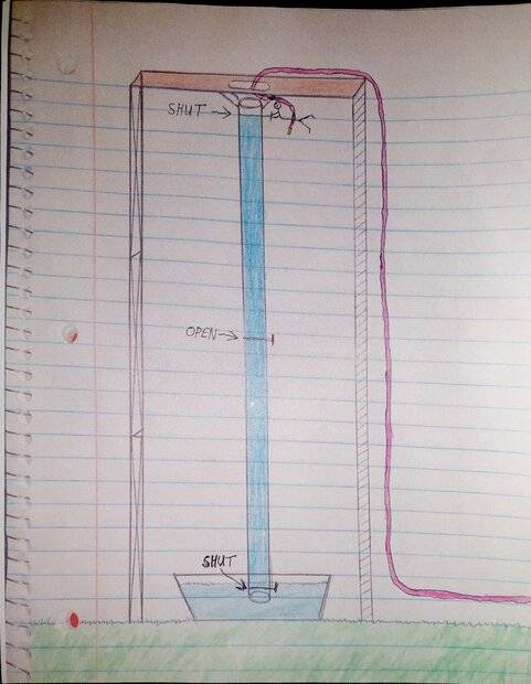

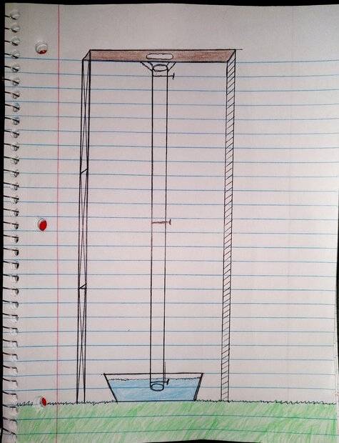

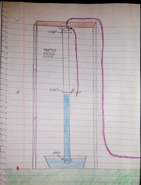

We start with a platform 20 meters high at sea level with a pipe suspended from it with three open valves (one at the bottom, one just above 10 meters from the ground and one at the top) with the bottom of the pipe submerged in a pool of water. (Fig 1)

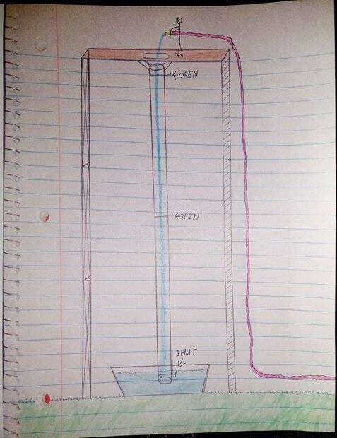

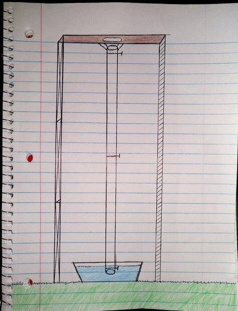

Then we close the valve at the bottom of the pipe and fill the pipe with water. (Fig 2)

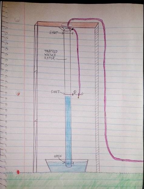

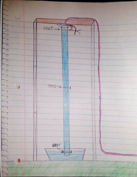

After the pipe is filled with water, we close the top valve. (Fig3)

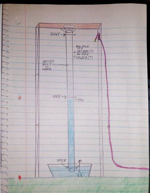

Then we open the bottom valve.

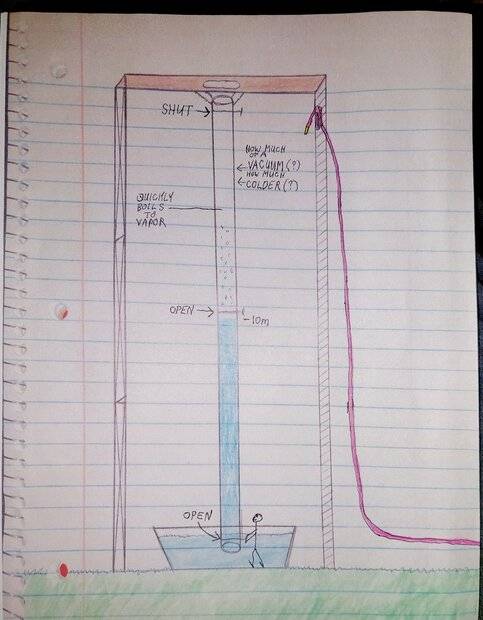

I believe atmospheric pressure leads to the water boiling to the 10 meter mark. I believe that water vapor takes up less room than liquid water. I believe that the pipe will be cooler due to liquid losing heat energy when it converts to gas. Am I correct so far? FIig 4)
How much cooler would that top chamber be (I realize that it depends on the volume, I'm looking for a formula)?
Would any impurities in the water separate from the vapor now that it's not in a liquid solution? Which? Metals and other minerals? Would it depend on their density?

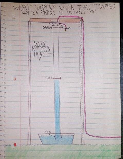

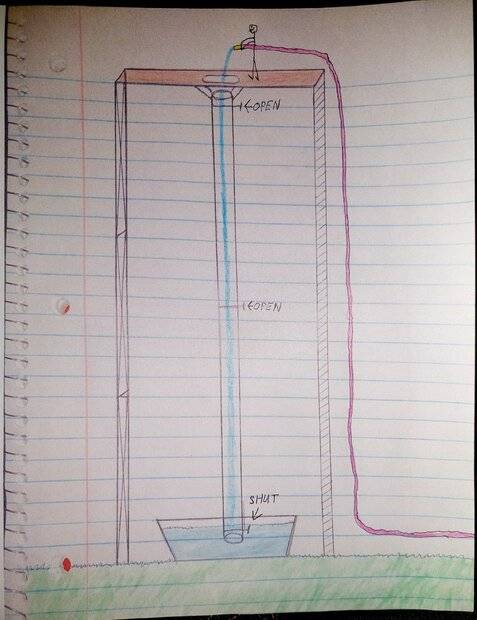

Please ignore the vacuum question for the moment. I believe that I can better ask that question in reference to an upcoming diagram.
Then we close the middle valve. (Fig 5)

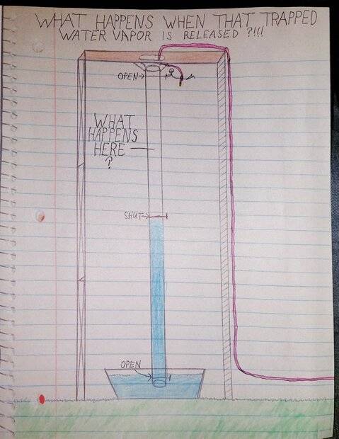

Then we open the top valve. (Fig 6)
What happens in that top chamber?
Is there a vacuum? If so, is there a formula to show the force of the vacuum created relative to its volume (what is it)?
Does the vapor condense into liquid?
Is it a fairly passive reaction (like a sudden mist appearing and gently forming into larger droplets and collecting on the bottom of the chamber) or violently (like with thermal shock)?
Would it be uniform with kind of a cascade forming on one end end moving towards the other (like tapping a bottle of super cooled water and watching it freeze across the bottle)? Or would pockets develop in seemingly random parts of the chamber nearly instantly pulling and pushing on each other creating chaotic looking turbulance? Or something else altogether?
Would anything that came out of solution come back into solution, or would this distill some of the impurities out of the water?
What would it look like?

So let's begin (if it's alright with you) with my primary question. In the last picture that I posted, a 20 meter(-ish) pipe was previously filled with water with the bottom of that pipe submerged while a valve at the bottom was shut (preventing the water from falling straight through). Then the valve at the top of the filled pipe was closed. Then the valve at the bottom of the submerged pipe was opened. At which time, all of the water within the pipe above 10 meters(-ish, assuming the bottom of the pipe is at sea level) boils into water vapor due to atmospheric pressure). Then a valve just above that line of water vapor (roughly just above 10 meters) is closed trapping that negatively pressurized (compared to the outside) water vapor. Then the top valve is opened quickly.
What does that look and sound like?
Assuming there's no wind, does the vapor turn to liquid in the pipe? Is it a cascade effect? Does the pressure difference cause the vapor to form above the pipe? Is it a violent or elegant reaction (like tapping a supercooled bottle of water and watching the ice form through it progressively from one side to the other? Is it cold due to the heat energy lost in the reaction?
Yes, many questions. But really just a single thorough description of the event will answer most of them. I can't imagine the event lasting longer than a few seconds. What are those seconds like?
I do have more questions. But this is the one that inspired the others.
If you would walk me through those 3-5? seconds, I would really appreciate it.
Not exactly.
Boiling is typical of a liquid heated from below, where bubbles of gas move up through the liquid.
ALL the water within the pipe does NOT boil, nor evaporate. The entire column of water fell about half way, leaving water vapour in its place above 10 metres.
The steam tables show the vapour pressure of water at 20°C is 2.336 kPa.
In this case, the surface of the liquid evaporates to fill the space above the falling water column. It is the surface that evaporates because water below the surface is under higher hydrostatic pressure than the surface water, so the surface evaporates first.
The 10-metre level is decided by the Atmospheric pressure pushing up, balanced against the density of water pushing down.
The upper section contains water vapour at an absolute pressure of about 2.336 kPa. When the top valve is opened, a bolt of air accelerates into and down the upper tube, hitting the closed mid-valve and being reflected back up the tube. It will sound like a double pop. The first will be a depression wave, as the column of air begins to move, followed by the pressure wave reflection that will be about 20 metres delayed, 60 ms later. What happens with multiple reflections is the sound of an organ-pipe, and needs to be modelled using transmission line theory or numerical simulation. The sound will have a distinct note, I guess somewhere around 1/0.06 = 16.5 Hz, more like a flutter or fart than a sound.
As the bolt of air accelerates down the tube, the pressure of the water vapour in the tube rises, so the water vapour dissolves in the wavefront of the air. A mist or cloud will NOT form ahead of the accelerating wavefront. Mist may appear just behind the wavefront and in the upper tube during the acceleration, from humidity in the air and the pressure drop at the entrance. The visual effect will be determined by the relative humidity at the time, and the shape of the open-end of the tube.

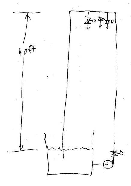

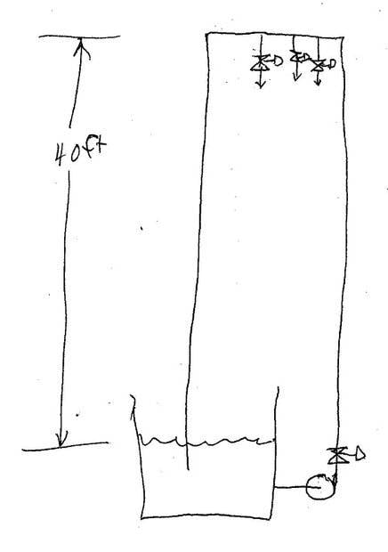

It may interest you to know that this is not just an abstract physics problem, but a real world problem that tripped up at least one engineer. The diagram below shows the system. A tank containing ##TiO_2## slurry with specific gravity about 2, had a pump that supplied a distribution pipe located about 40 feet above the tank liquid level. The line had a valve located just after the pump that opened when the pump was on, and closed when the pump turned off. The discharge end of the line was below the surface of the slurry.
Hand-drawn sketch of a tall vertical pipe rising from a tank of liquid, with three valves near the top, a pump and valve at the bottom, and a 40 ft height marked on the left.
Every time the pump started, there was a KABLAAMM that shook the pipes enough that the pipes were in danger of breaking.
The flow rate and viscosity were such that the entire line ran full when the pump was running. When the pump stopped and the valve closed, the slurry continued to flow until the liquid level in the downward portion of the pipe was about 15 feet above the tank liquid level. There was a vacuum* from that point up to the distribution pipe at 40 feet up. When the pump started up, the flow was helped by the vacuum until the new supply of slurry met the slurry standing in the downpipe with a loud crash.
The solution was to add another valve in the downpipe just above the tank to keep the slurry from running down and creating a vacuum gap. Problem solved.
*More correctly water vapor as discussed by @Baluncore above. But for engineering purposes, it's a vacuum.

The loss is not relevant. The water remaining in the column will reach to about 10 metres above the surface of the pool. It has little to do with proportions, and much to do with atmospheric pressure and the density of water.
The sectional profile of the tube is also irrelevant to the question.
ChicagoDad said:
If the pipe is full of water and the middle valve open while the bottom and top are shut. Then the bottom valve is opened to effect the pressure inside. Then closed. Then the top valve is opened just enough to let air in. How full of water will that pipe end up being?
1. When the top valve is closed, and you open the bottom valve, you have made a water barometer. The top of the water column will settle about 10 metres above the surface of the pool. That 10 metre water column is supported by the atmospheric pressure on the surface of the pool.
2. When you close the bottom valve, you fix the water level and volume in the barometer.
3. When you open the top valve and so let in the air, you have made a tall bucket, with water remaining 10 metres deep. (That is, assuming the bottom valve was at the same level as the surface of the pool).
The sectional profile of the tube is also irrelevant to the question.1. When the top valve is closed, and you open the bottom valve, you have made a water barometer. The top of the water column will settle about 10 metres above the surface of the pool. That 10 metre water column is supported by the atmospheric pressure on the surface of the pool.
So once the liquid water becomes water vapor, re-pressurizing won't turn it into liquid water again?
I didn't see that one coming.
Yes. A big water barometer. Exactly. I just assumed that the water vapor would become liquid again when air was reintroduced minus the volume lost through the bottom of the pipe early in the process and the other gases (impurities) that came out of solution.
My next set of questions WERE going to be about how much of a decrease in pressure would it take for the water vapor to become water again. My next proposition WAS going to be... actually still is:
Instead of a single 20m pipe with a valve at the top, middle and bottom, if there were two 10m pipes with valves on either end that could be connected. And the rest was essentially the same leaving the bottom pipe full of water who's impurities that would be lost to gasses freed from solution under those conditions already freed and trapped in the top section. Then doing it again with another pair of pipes. Then taking the two bottom pipes filled with water and disconnecting them from their top pipes with the trapped water vapor. Then connecting the water filled bottom pipes together and sticking the bottom of one end in a pool. Then opening the bottom and middle valves.
Do you get the same result? My instinct says yes. But my instinct also thought the water vapor in the top section would form into liquid again when re-presurrized.
Why doesn't that happen? Is it that evaporation pulls the gasses apart, but it takes some sort of catalyst to get the hydrogen and oxygen molecules to bond again? If so, what sort of catalyst?
Thank you for sharing that. It is neat to know that the same thing happened in a real life scenario.
I had assumed that dry air was introduced from above.
At 20 °C the ppH2O = 2.336 kPa.
If the air introduced was 100% water saturated, assuming there is 10 m of vapour above the liquid, (in a cylindrical tube);
10 m * 2.336 kPa / 100 kPa = 0.230 m.
So yes, some of that vapour may condense, and it will make somewhere between zero and +230 millimetres of liquid level difference.
But, what will the Relative Humidity, RH%, be on the day of the experiment? More water may be introduced from above, as vapour in the air, that you allowed to fill the partial vacuum. If the RH% was zero, then there would be no change in the liquid level, as all the vapour present could dissolve in the dry air that entered.
Now we have an important counterintuitive back step, and about face. In effect, the rise in the liquid level is totally due to the water content of the air that you allowed to enter from above. You need to start with a simple and well-defined model and analyse that, before you introduce environmental vapour pressure corrections and thermal refinements to the model.
