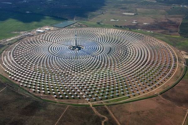

  3. On the hot side, I am imagining simple solar concentrators to keep the water above 90 degrees. On the cold side, I am imagining a simple heat exchanger keeping the temperature below 10 degrees. Solar concentrators and heat exchangers have a very long life span and recyclable. I chose the number 10 degrees and 90 degrees because it seems broad enough to be useful, and not so extreme that it would be difficult to maintain the temperature.

Concentrated solar power is a very promising direction.
