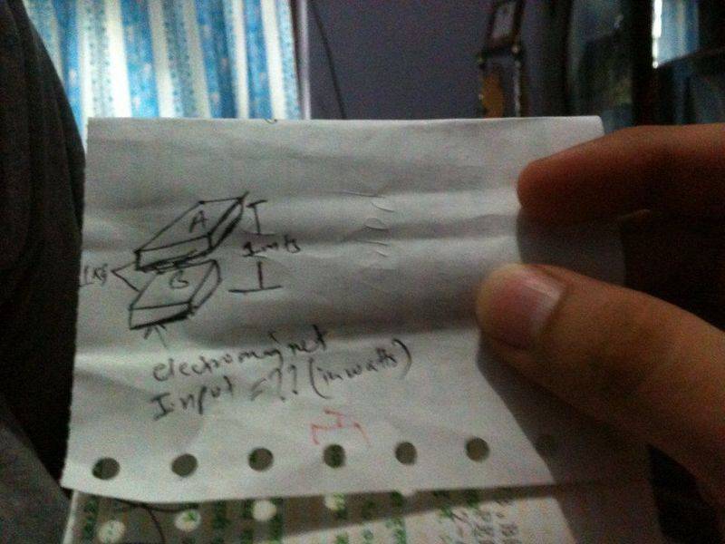

How much power is required to lift the object A from the base B to a height of 1 meter if the given object A weighs 1 kilogram?
No idea
N/A very very confused what to do about this question..

You are asked to lift an object using an electromagnet. Is object A a permanent magnet? Please state the complete problem clearly.

Surely you can find relevant equations. Also, are you sure that the problem statement is correct: you are asked to calculate the power?

Assume object A is magnetic material having same pole of the electromagnet's surface it's exposed to.

Power is Joules/second. There is no mention of time in your problem.

The problem is now clearer. It is no the power to lift, but to maintain the height against gravity.

Okay take it this way then... How many watts is it going to take for the electromagnet(if you need to know anything about the specs of magnet just ask) to complete the task?

I think that your problem is way underdefined. We have no idea what material the hovering object is made of, are any characteristic of the electromagnet.

okay, the time is 1 sec and the electromagnet's specs is what I'm Trynna figure out here... I want to know what the electromagnets power output should be..

And the material like I already mentioned: it's magnetic, and if facing the electromagnet as such the like poles of material and magnet are facing each other. I don't know how can I be more clearer atm.

Maybe you mean unlike poles face each other?
Whatever the case, I don't think anyone will be able to come up with an answer for you. You want a magnet so strong that it will reach across 1 m of air to hold a 1kg weight in place, so say 10N at that distance. Magnets work best through narrow gaps of air. The big electromagnets on the end of cranes in metal scrapyards might not even manage your task.

I think the idea is the electromagnet is on the bottom and repelling the object while gravity is pulling down on the object, so you want the same poles facing each other.
There is no simple calculation for what you are asking, and it is most probably not achievable.
