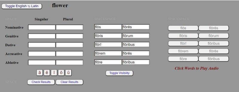

Here is a link to the full page I uploaded to 000webhostapp. This is obviously not an optimal or best practices example but I did manage to learning a lot of the language by doing this:
Latin Nouns Exercises page in Javascript
Here is the single file for it (see attached) and here is an image of what the page looks like. I made the input fields so light up green if correct value is entered, also managed to find a solution for keeping the cursor at the end of the value. Originally and annoyingly the user would click a macron button and cursor would go back to beginning after putting macroned letter.

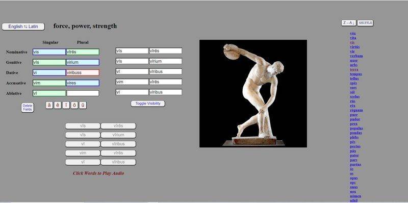

Here is latest code for the macron button. Only thing is that if user clicks down on one button (continues to hold down) and drags cursor along to other button and releases, the word "undefined" shows up in the field. I will need to catch that with something. Another thing needs catching is if user highlights whatever text is in the field, 'flōs' let's say, and then clicks on macron letter 'ī' (e.g.), it enters the 'ī' but also the other highlighted text. So a highlighted 'flōs' becomes 'flōsīflōs' if 'ī' is selected while 'flōs' is highlighted.

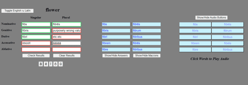

Big thanks for this! Will incorporate this knowledge definitely.
What the if statement
JavaScript:
if (typeof el.selectionStart == "number") {

does is keep the cursor at the end of the string. Originally when user would click a macron button, if they would click another macron button right after that the character would feed in from beginning of string, the cursor would move all the way to the left. This keeps cursor at right most position in the string.
Another thing I fixed was if user clicked on macron button, held down, and dragged right and released, the word 'undefined' would appear in the input field. I thought I fixed that with:
JavaScript:
if (newString != 'undefined') {
        element.value = newString;
but it only worked if not already a character in the field. Once a char is in the field, now if user did the sloppy click-slide, 'newString' is no longer just 'undefined' but, e.g., 'ōundefined' which the if statement did not test for. So to fix this I made a new if statement with match() and a regex :
JavaScript:
var newString = element.value.slice(0, element.selectionEnd) + macron + element.value.slice(element.selectionStart, element.value.length);
result = newString.match(/undefined/g);
if (result != "undefined") {
which tests if 'undefined' is anywhere in the string at all, and if so it just doesn't put the value for newString into element.value but waits for a correct click again. Starting over with what is already in the field. The value 'ōundefined' is discarded and becomes 'ō' again. Etc.
There is yet another annoying behavior I want to fix then its on to a week of REACT and getting comfy with VSCODE. Then following week will look at some other stuff you mentioned.
The thing I want to fix is if user (for whatever reason) select highlights text in field and then clicks on macron button, it puts the macron PLUS all the selected stuff as well. So that a selected 'flōr' becomes 'flōrēflōr' if the user clicks macron button 'ē'.
By the way I love this kind of stuff, but I need a job so moving on.
Again thanks for critique! Will incorporate into my practices.

Here is latest file and site. I added two more noun pages which can be accessed by clicking on linked nouns.
https://thelatinroom1.000webhostapp.com/index.html
btw just now getting to reviewing your critique. Making changes right now. Good stuff!
@pbuk
ok so I implemented some of your critique:
1. Your suggested line:
JavaScript:
document.querySelectorAll("button[data-macron]").forEach((el) => { el.addEventListener("click", putMacronedLetter);});
in place of my:
JavaScript:
document.getElementById(macronButtonsID).addEventListener("click", putMacronedLetter);
did, in fact, make the undefined error catching if statement unnecessary. Before, when user would click on macron button, hold down and drag off of it, the string 'undefined' would appear in the field. Now it does not. But to get the macron value from the data attribute 'data-macron' in the macron html buttons, I had to (in function putMacronedLetter() )' replace:
JavaScript:
            const clickedThing = event.target;
            const macron = clickedThing.value;
with
JavaScript:
            const macron = clickedThing.getAttribute('data-macron');
Here is full relevant code with my old lines commented out and your new implemented. One thing though, the format specifier ${i} of the for loop in your suggested code for consolidating the eventListener arguments "click" and "keyup" into one event listener with "focus" ended up freezing the page, nothing would work. But I did implement "focus" in one listener instead of "click" and "keyup" in two and that worked fine, just the format specifier creates error somehow.
All other of your suggestions appear to work and be major improvement. I am not fully done implementing all of it yet though.

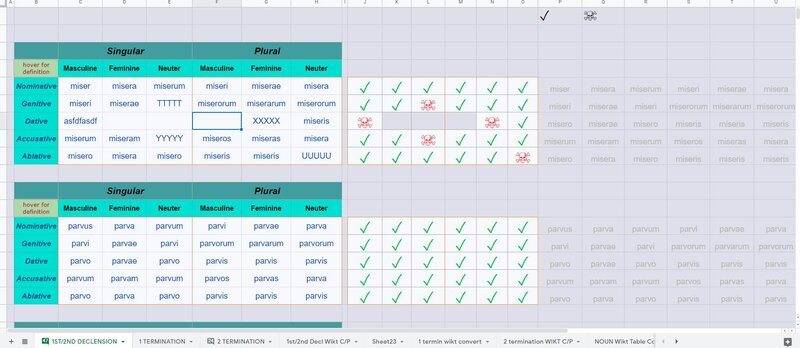

One of things I have vision for is functionally simple, cosmetically 'muted' (not too much 'make-up'), online Latin language learning webpage. (Also I have friends who teach Latin at local schools).
I created this recently in Google Sheets and it is what kind of spurred me to see if I couldn't make something similar and even better as a webpage. The styling for the table headings/labels is exactly same for Latin nouns/adjectives in wiktionary. I have this set up where all one has to do to create more tables is go to Latin word in wiktionary, select/copy the table for given word, then bring and paste into another sheet in workbook that with a single paste automatically removes all macrons and places words in order in a grid easily transferable to the one shown here. It literally takes seconds for me to set up one of these table entries from the moment I search the Latin word in Google to the moment the study table shown here is created. I have 50 of these entries on this particular sheet. What I eventually want to do is create a website with similar and better functionality. One where all user would need to do to create a study table is copy table from wiktionary and paste into a grid on the page. The page would then create a new study table with one click.
(obviously for copyright issues, I would use a different styling on webpage : ) )
In this google sheet, to study, user wd simply delete entries of left table (not delete formatting of course!), the formulas are written so if no word in cell, the corresponding cell in the checks/skulls grid shows blank. The answer key is grayed out but still visible on the far right.
[EDIT: meant to mention, if user wants definition info on word, they hover over drab colored cell]

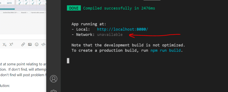

Ok will be probably creating new post elsewhere at some point relating to any obstacles I encounter with Vue. Just encountered one. Googling for solution. If don't find, will attempt to find an existing solution here in physics forums programming section. If still don't find will post problem for help.
e.g., just ran into this and looking for solution. Also vue project I just created not showing up in projects folder. This is not an officially ask for help post just forecasting that I will be resourcing this forum for Vue snags.
Network unavailable? Sounds like a firewall issue; whatever firewall software you are running on your PC is not letting node.js connect with the outside world.
Not sure what you mean by 'projects folder'. Windows can do some strange stuff with user folders, I do all my development on Windows under a root folder (C:\Projects) which Windows tends to leave alone. This also helps keep it out of any backup and indexing which doesn't play nicely with software builds/version control bulk changes.

Regarding my latin nouns page, I am moving on from that but I did manage to make some significant progress in it since last post about it. Replaced all var with let. Replaced all direct html references/ids etc with variables. Also improved / fixed bugs to the input field entry tester.
I made it where user could toggle a "Quiz Type" button to toggle between taking the quiz with macrons or without macrons. If they are only half done with quiz and click on "Quiz Type" it erases all fields and starts over with alternate quiz with or without macrons. And some other things.
The html is a mess and would break on any number of devices but the main value of this was it was a baptism into basic vanilla javascript. Turns out I really really enjoy lower level coding and honestly this wet my whistle to maybe get into something C/C++ related later on but right now my main focus is to acquire a job.
here is latest script for latin nouns page and see attached for index.html if you care to look at page. The 000webhost page is days old version.

Also eliminated toggle quiz type. Now if user enters correct value but without macron the background lights up very lightblue with darker blue border, if correct value but with macron, background is very light green with darker green border, and if incorrect value, lightred and red, etc.
Also working on new look. Eliminated "Toggle Quiz" button, now user just toggles visibility of answers key so that they become almost completely grayed out but still barely visible. Also wrote a function that makes millisecond delay between each readonly field value as they disappear and reappear. Also uses a toggle between style classes method, element.classList.toggle("alt-class"). Nifty!

Right now I am trying to make it so the only event that triggers the testValue() function is "input". Problem is that if last character entered by user is a macroned letter, that is done with the put macron button which somehow hijinks the "input" event so that it doesn't register with the testValue function. When I added the "focus" event, suddenly it worked, but the reason is because in the putMacron function there is the line:
el.focus() which gives focus back to the input element thus triggering the event for testValue(). The reason I don't just use the "focus" event is because it does not work when tabbing away from field to next field. It leaves the entered value completely unevaluated, especially if no macrons where entered.
So both "input" and "focus" work perfect together. But I want to maybe include some line in the putMacron() function that cause the "input" event to trigger to evaluate value immediately upon macron entry so focus event is not necessary.
With the "input" event the field lights up red the moment a character is entered and turns either blue or green the moment the latest typed character achieves the full correct value, blue if value with no macrons, green if value with macrons. And I really like that functionality for this kind of quiz. The "focus" event alone does NOT do that. And I am trying to avoid using multiple events.

New look:
Looking good, and you are really getting to grips with how to write DRY code in JavaScript.
I see you experimented with a few events: I often use the change event but I don't think that is going to help you here. Probably best to just rrigger the event at the end of putMacron with el.dispatchEvent('input').
Another improvement to consider is to do the styling with CSS classes and use el.classList.add/remove. This would make it easier to change your mind about how things are styled using e.g. dotted borders for some values, or use different styles in different circumstances which can help accessibility. On the subject of accessibility you could see how your page rates using a tool like the Lighthouse plugin for Chrome.
I also suggest you get to grips with git. If you host your code on GitHub you can have it deploy automatically to free servers (conditions apply) like GitHub Pages or Netlify and you can ditch that amateur web host.
pbuk said:
. . . I often use the change event but I don't think that is going to help you here. Probably best to just rrigger the event at the end of putMacron with el.dispatchEvent('input').
Your el.dispatchEvent('input') actually worked but needed a new event declaration.
JavaScript:
    var event = new Event("input");
    el.dispatchEvent(event);
Had to use 'var' to declare the new event.
'let' generated an "Identifier 'event' has already been declared" error.
Anyway I am happy with this solution because it seems native and logical rather than just a workaround, like pairing "focus" with "input" would be. I want an integral feature of the putMacron() function to be that it registers the putting of a macron as an "input" event that is 'hearable' by el.addEventListener("input", testValue);
JavaScript:
        function putMacron(event) {
            const { macron } = event.target.dataset;
            const el = document.getElementById(currentInputElementID);
            el.value =
                el.value.slice(0, el.selectionEnd) +
                macron +
                el.value.slice(el.selectionEnd);
            el.focus()
        document
          .querySelectorAll("input[data-macron]")
          .forEach((el) => {
JavaScript:
Good catch - this would be even better as new InputEvent('input').
Noooo! That is the JS engine working as it should do - you declared the variable 'event' on line 1 when you used it to name a function parameter
JavaScript:
so the right fix is to choose a different name, or just create and fire the event in one statement:
JavaScript:
el.dispatchEvent(new InputEvent("input"));
Renaming variables that are already in use can break things so is something to be avoided - and the fact that let and const prevent this is one of the main reasons we don't use var any more.
@pbuk
PREFACE NOTE: OBVIOUSLY, there is a standard way to do this. I just need to learn what it is.
My next major project, starting today is to make it so when user clicks on a new noun from a list of nouns, the appropriate data throughout the html file itself is repopulated with new noun data from some data interchange containing, e.g.:
terra terrae
terrae terrārum
terrae terrīs
terram terrās
terrā terrīs
I need it to automatically load to all appropriate positions in HTML file and become the new page for a user to study with.
HTML:
<input  id="vis-field-1" type="text" data-macron="vīs" data-plain="vis"><input id="vis-field-6"  type="text" data-macron="vīrēs" data-plain="vires"><br><br>
<input id="vis-field-2" type="text" data-macron="vīs" data-plain="vis"><input id="vis-field-7"  type="text" data-macron="vīrium"data-plain="virium"><br><br>
<input id="vis-field-3" type="text" data-macron="vī" data-plain="vi"><input id="vis-field-8"  type="text" data-macron="vīribus"data-plain="viribus"><br><br>
<input id="vis-field-4" type="text" data-macron="vim" data-plain="vim"><input id="vis-field-9"  type="text" data-macron="vīrēs" data-plain="vires"><br><br>
<input id="vis-field-5" type="text" data-macron="vī" data-plain="vi"><input id="vis-field-10"  type="text" data-macron="vīribus" data-plain="viribus">
becomes this with a single click by a user.
HTML:
<input  id="terra-field-1" type="text" data-macron="terra" data-plain="terra"><input id="terra-field-6"  type="text" data-macron="terrae" data-plain="terrae"><br><br>
<input id="terra-field-2" type="text" data-macron="terrae" data-plain="terrae"><input id="terra-field-7"  type="text" data-macron="terrārum"data-plain="terrarum"><br><br>
<input id="terra-field-3" type="text" data-macron="terrae" data-plain="terrae"><input id="terra-field-8"  type="text" data-macron="terrīs"data-plain="terris"><br><br>
<input id="terra-field-4" type="text" data-macron="terram" data-plain="terram"><input id="terra-field-9"  type="text" data-macron="terrās" data-plain="terras"><br><br>
<input id="terra-field-5" type="text" data-macron="terrā" data-plain="terra"><input id="terra-field-10"  type="text" data-macron="terrīs" data-plain="terris">
Part of the functionality of such a data load function will need to include:
1. replacing parts of strings in variable values so that
JavaScript:
let fileAudio = "terra-audio-";
let inputField = "terra-field-";
// becomes
let fileAudio = "vis-audio-";
let inputField = "vis-field-";
with a single click by an end user. The goal, obviously, is to avoid creating a thousand html files for a thousand different Latin words but instead using one html file that loads everything it needs to change to new noun from some data interchange that itself could be created in mere seconds as opposed to the 20 to 30 minutes it could take to duplicate an html page and manually replace all values, especially if I expand this project to include verbs with conjugation tables!
This would obviously save me months of work. I just need to learn how to do it.
