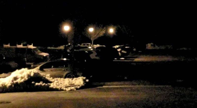

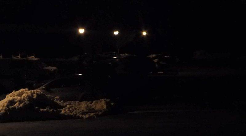

olivermsun said:
I don't believe it's actually true that modern cameras are inferior to the human eye for dynamic range.
I'm not trying to be condescending here, but do you do much photography beyond just basic snapping? It's a huge and well known problem. Take a photo outside of something backlit - you'll notice the subject is near totally black in the photo yet you have no trouble seeing them yourself. It's why people use flashes and professionals use massive reflectors to illuminate their subjects outside -- and that's during the daytime!
Automatic adjustment when you have oncoming headlights mixed with darkness is a difficulty, however.
Yes, and in this case, the AI has to decide which it wants to see well: the brightly lit area near the car or the darker area further away and adjust accordingly.
Note though that this part of our discussion probably doesn't matter much. As far as we know, this was a dashcam, and not part of the car's self-driving system.

  • #124
No offense, but you are being a little condescending here. I've been a reasonably serious photographer for a few decades now, including paid work for some years. I'm professionally interested in sensor design and data processing, so if you have some better sources I am all ears (eyes?).
A big part of that problem is metering. Use a modern digital sensor and "develop" the raw data correctly, you will realize that you have more dynamic range available than your output medium is capable of displaying. Hence the old -1.7 stop fill flash trick is much less a "thing" now than it was in the slide film days. :wink:

  • #129
I didn't know, so I asked - but that is shocking to me. Here's some sources:
http://clarkvision.com/imagedetail/eye-resolution.html
https://photo.stackexchange.com/que...-human-eye-compare-to-that-of-digital-cameras
https://www.cambridgeincolour.com/tutorials/cameras-vs-human-eye.htm#sensitivity
I'm aware of this, but it is highly unlikely a dashcam is shooting raw 14bit (per channel) images. More likely 8bit.
Please note: one of the big advantages of cell phones - which is probably what was used in that demonstration - is that they are little computers and as a result can do on-the-fly post processing that stand-alone cameras often can't (though they are getting better). I just took a few photos/videos with a quality point and shoot (Panasonic Lumix DMC-ZS50) and my Samsung Galaxy S8 and the difference is big:
The Lumix has the far superior camera and lens, but the Galaxy is clearly post-processing the video to boost the brightness (albeit making it noisy) before writing it to disk...and even then, the scene from the Canon is far inferior to what I could see with my eyes.
Given your experience, I suspect you are viewing this from a perspective of high-end equipment that doesn't match well with what we are dealing with here.
  • #130
I'm confused. Which part is shocking to you?
I am not sure what I am to take away from those sources. We are talking about instantaneous dynamic range, I assume, not the dynamic range of the eye-brain system allowing for tens of minutes of accommodation. What do your sources say? What about actual studies of the human visual system?
If a video camera his being used for vehicle navigation/collision avoidance, it should probably be better than 8-bit. This is an experimental self-driving car that probably costs more than $150. I have no idea what is the source of the video we're being shown publicly, but the vehicle better have something more than an 8-bit backup camera sensor.
View attachment 222622 View attachment 222623
Plenty of modern cameras offer on-camera dynamic range adjustment, compression, and even editing. We're not talking ultra-high-end equipment, but current < $500 system cameras.
But to return to my earlier point, I can't see why a self-driving car would have a less capable camera and image processor than a cell phone (which these days is pretty darned good) or a cheap system camera. That would seem to be a poor engineering decision, given the total costs of the system and the goal of the demonstration.

  • #133
That you haven't noticed the dynamic range problem that digital cameras have vs our eyes.
Agreed. I'm not seeing a problem in the sources.
From the third link:
Dynamic range* is one area where the eye is often seen as having a huge advantage. If we were to consider situations where our pupil opens and closes for different brightness regions, then yes, our eyes far surpass the capabilities of a single camera image (and can have a range exceeding 24 f-stops). However, in such situations our eye is dynamically adjusting like a video camera, so this arguably isn't a fair comparison.
Eye Focuses on Background Eye Focuses on Foreground Our Mental Image
If we were to instead consider our eye's instantaneous dynamic range (where our pupil opening is unchanged), then cameras fare much better. This would be similar to looking at one region within a scene, letting our eyes adjust, and not looking anywhere else. In that case, most estimate that our eyes can see anywhere from 10-14 f-stops of dynamic range, which definitely surpasses most compact cameras (5-7 stops), but is surprisingly similar to that of digital SLR cameras (8-11 stops).
On the other hand, our eye's dynamic range also depends on brightness and subject contrast, so the above only applies to typical daylight conditions. With low-light star viewing our eyes can approach an even higher instantaneous dynamic range, for example.
If the "arguably is not a fair comparison" part is what you are referring to, there are two things to take away:
1. Fair or not, it is real. Our eyes rapidly adjust and enable us to see a vastly higher dynamic range than video cameras. Perhaps the video camera could be programmed to take different exposures and combine them or post-process and boost the dark areas like my cell phone did, but clearly the video in question didn't.
2. Even including the "not a fair comparison" part, the eye is still much better than the camera instead of vastly better.
To be honest, I see this as such a mundane, everyday issue that it hadn't occurred to me to look for scientific studies of it. I'm not even sure what one would try to say with a study, since it might end up looking like a product comparison against a specific camera. I don't think that's a subject for scientific research and a little bit of googling came up empty. But if you have any sources that you think are more relevant, I'd be happy to read them.
If a video camera his being used for vehicle navigation/collision avoidance, it should probably be better than 8 bit.
Agreed. Please note, the quote of mine you responded to was discussing the dashcam footage. I would hope the navigation/collission avoidance cameras are better.
It says "dashcam", so I assume it is a commercially available dash cam. No doubt it cost more than $150 (not sure where that number comes from), but I highly doubt even higher-end dash cams record in anything higher than normal HD, at 10bits color depth (and compressed). The file sizes would be unwieldy.
Plenty of modern DSLRs offer on-camera dynamic range adjustment, compression, and even editing.
Ok. Clearly, the dashcam used in the video we are discussing was not a DSLR and didn't do that sort of processing.
